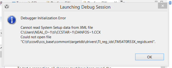

I have been using CCS6 with XDS100 v1 and v2 boards for some time now, and have recently run into a launching issue.
On Friday of last week, I run the CCS Check for Updates and some software update, just in case they would help with my attempts as getting DSS and Console Scripting to work (I'm a beginner, and was unable to get the examples fully working).
Now, on Monday, I am unable to get my debugger to launch, even in manual mode, with either type of debugger board, even to just the basic connect level. See image for exact error.
My target configuration has not changed, and has nothing to do with the TMS470 stuff, so I don't understand why that file is being accessed.
I have quickly rerun the CCS6 installer I use, but it didn't indicate there was any issue or corruption with the current install at all.
I have tried uninstalling the attached debugger in Device manager and letting it reconnect, and no change occurs there either.
I am attaching the image of the error, the install log zip files I can find, and my ccxml file (which is unchanged as far as I can tell).
Many of the help forum post with similar issue to this seem to end up with no contact from poster, so I am not finding a full solution to this issue, and would like assistance.
Thank you

  • That TMS470R53X file is interesting. I don't have it in my v6 installation. It must have come in a recent update. I am updating my v6 installation now and will try it out
    ki
  • I updated my v6 environment and the file now appears in the directory. However, I am still able to launch a debug session using your ccxml file.

  • ngohara1991 said:
    Are there any ideas about configurations settings to share for details, or metadata files to delete manually?
    If you temporarily change the file extension on the TMS470R53X_regids.xml file in the error message does that change the error or allow the debug session to start?
    When CCS starts a debug session I think it parses all device XML files, even for targets you are not using.
    It looks like a CCS update has installed a new TMS470R53X_regids.xml file for a 64-bit ARM Cortex-A53 device which can't be handled by your CCS installation.
    it does change the error, but not by much. It becomes "Could not open file" instead.
    Clearly there is a list of all these files stored somewhere that it is going down.
    Why should it parse files for all chips, and not just the one in the target configuration? Is there a way to change this in settings?
    Barring that, how do I tell CCS to fix the installed xml files to what it can handle?
    Thank you for the assistance,
    Neal
  • This is very odd since your ccxml file is valid (still works for me after the update). I fear that you may have a corrupted installation. In the past, some people have resolved a similar issue by reinstalling CCS. I'd hate for you to have to go through that ordeal but it is worth a try. You may also want to consider updating your CCS version to something more recent.

  • I just want to confirm one more time that you did the following step:
    Ki-Soo Lee said:
    Deleting your target cache file:
    software-dl.ti.com/.../ccs_troubleshooting.html
    Did you run fsclean in: [CCS INSTALL FOLDER]/ccsv6/ccs_base/common/bin
    ki
    try this after you deleted the TMS470R53X_regids.xml file
  • After more investigation, it appears that the issue occurs if updating to the latest TI Emulator Pack (8.0.803.0) with old versions of CCS (like CCSv6). There is debate on if the latest TI EMU Pack updates should even be available with older CCS version. In any case, it is recommended to not update to the latest emu version with old CCS versions
