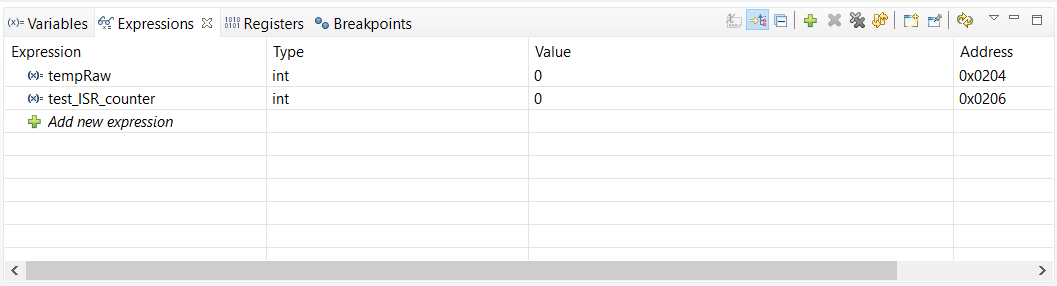

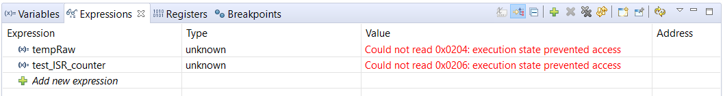

Hello, I am currently working with an MSP430G2553, which performs conversions with the ADC10 triggered by TimerA.
I created two expression to check the functionality of my programm:
- tempRaw: here I store the value from the Temperatur Sensor and wan to check the value with the expression
- test_ISR_counter: I want to check how often the the ISR routine of the ADC10 has been started
When I start the programm in debug mode the expression can not be read:  tempRaw unknown Could not read 0x0204: execution state prevented access (picture)
When I click the suspend button in debug Mode I can see values for both expressions (seems to fit to my programm) (picture)
Since I want to have my expressions updated automatically, I added an Breakpoint (--> refresh all windows) in the while loop. However, when I start the programm both expressions are not cahnged at all. (picture)
Now I have two questions:
1. Why do I get the error message "execution state prevented access"? Do I have to change something in my programm?
2. Why are my expressions not changed at all when I add an Breakpoint which is supposed to just update the expressions?
    In an MSP430, the Debugger is unable to read variables when the processor is running, thus the message. You have to halt the processor to properly update this view.
    The IDE can only update its screen fast enough - at 0.5s by default but, under several ideal scenarios, this could go as low as 0.1s. What you are experiencing, however, may be an artifact of both the compiler and the debugger
    - the compiler may have rendered the variable egkON as useless and removed it
    - with that, the source breakpoint would be hit only at the first interaction of the while loop
    In this case, two details should be expected:
    - The variable should have been declared as volatile;
    - The update rate will happen at a much lower rate than the ADC.
    Hope this helps,
    Rafael
