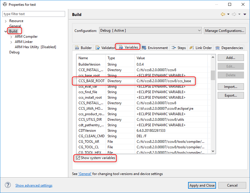

  • The definition of those variables can be seen in the below section of the project properties:
    PROJECT_ROOT is lower in the list if you scroll down.
    basically, CCS_BASE_ROOT points to a directory inside your CCS installation. PROJECT_ROOT is the path to the project folder. Neither variable will help with your build errors. You likely need to add 'C:\ti\simplelink_msp432p4_sdk_2_30_00_14\source' to the list of include search paths.

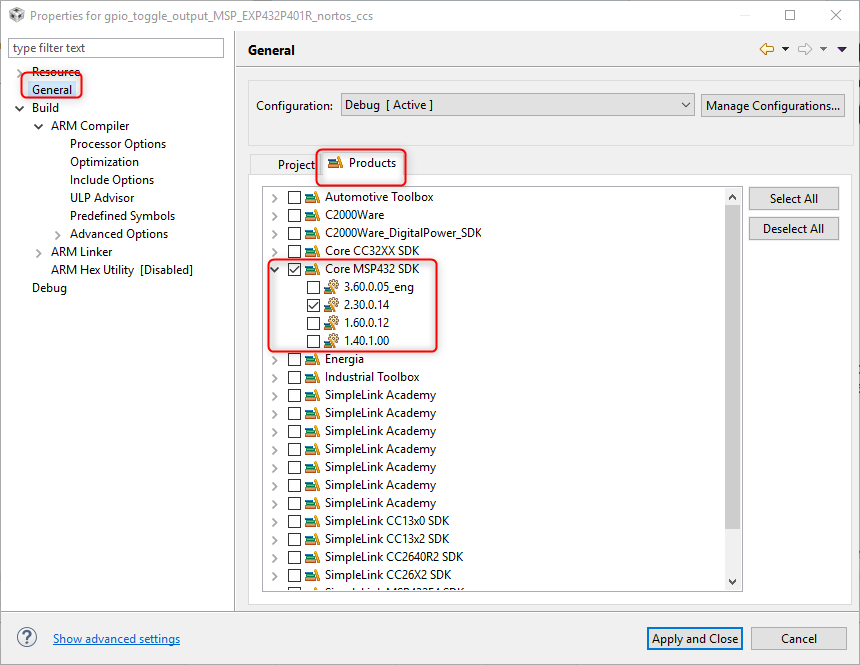

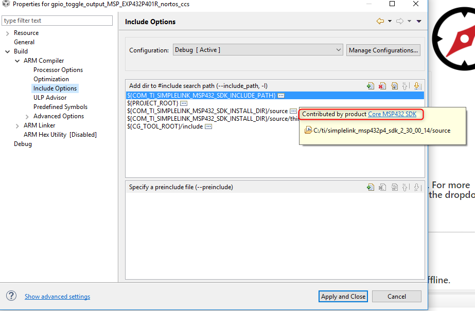

  • Chris Humme said:
    I still don’t know where these variables are listed or how they got defined. Did find some stuff on Stack Overflow when searched for Eclipse system variables but looked like it led to another tangent?
    They were likely defined by the MSP432 SDK.
    For example, where I go to the include options and check the paths, I can see that some of those paths came from another package:
    I can check which package by looking that Products tab of the General project properties:
    Hence if you have MSP432 SDK discovered by CCS and the product enabled in the project properties, then the variables should be defined.
    Hope this helps
    ki

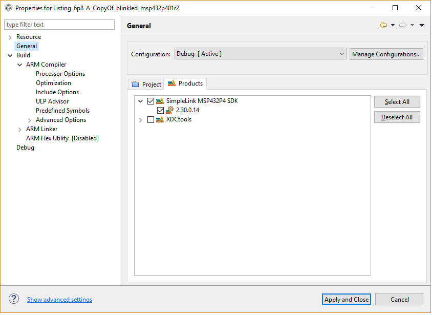

  • Hi Ki
    This is what I have for products
    I do not see any way to add 'Core MSP432'
    I did a web search and all I found was SimpleLink stuff which I seem to have already?
    So is 'Core MSP432 SDK' something different?
    If so where do I find it and how do I get it 'discovered'?
    Chris

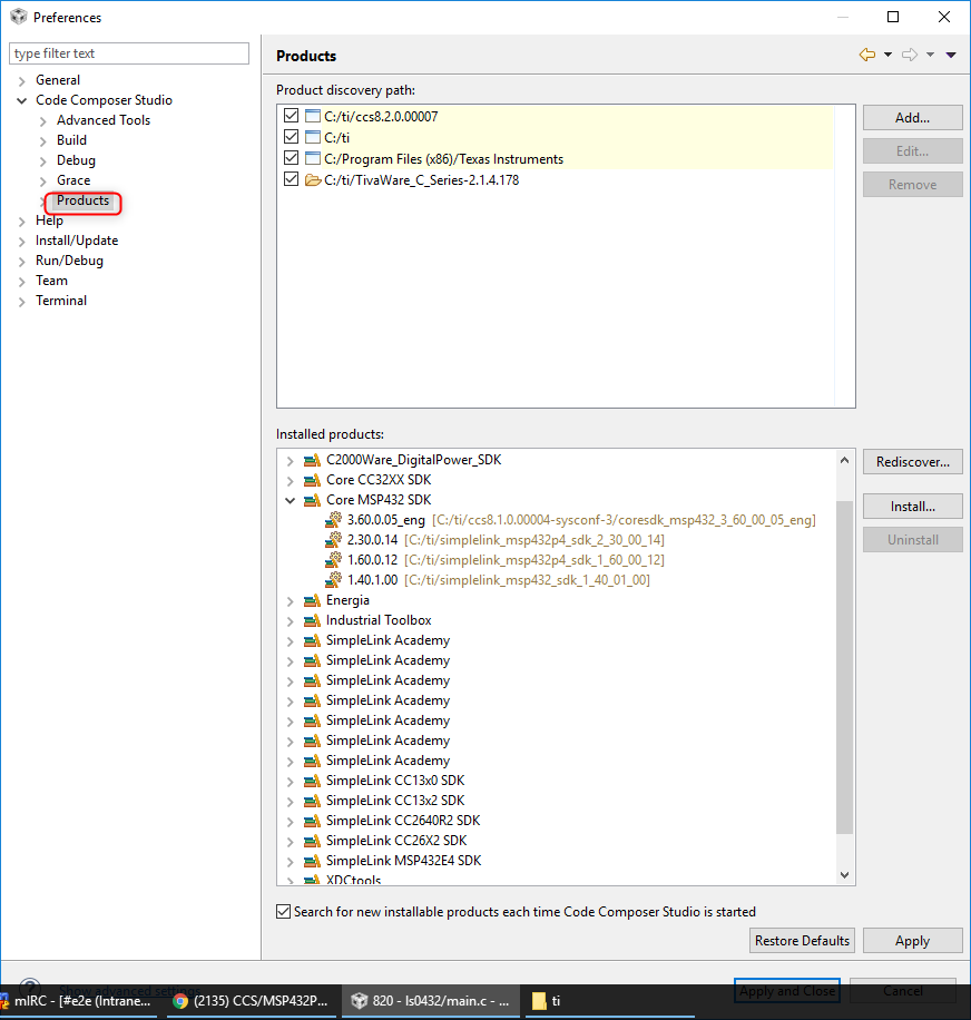

  • That is odd. Can you check the Eclipse preferences for the list of discovered products? Please provide a screenshot like below"
    ki
  • My main PC runs W10-64 and I ma working on reinstalling CCS8 on that PC.
    This screen capture is from a spare PC running fairly fresh install of  W7-32 SP1.
     I could not find CCS_BASE_ROOT or PROJECT_ROOT on either machine.
    I found out that the 'Core MSP432 SDK' and 'SimpleLink MSP432P4 SDK' point to the same thing. The names sometimes get mixed up, which is confusing, but otherwise not an issue.
    Hence if you have that ether product enabled in your project, the variables should get passed on from the SDK to your project. You will not see it defined in your project since it is coming from the SDK.
    Hope that helps clear things up.
