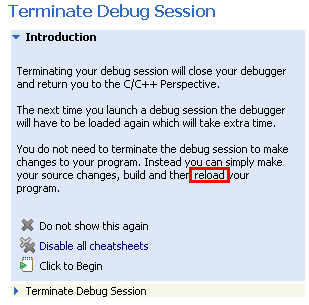

In addition to this "reset" question, there is also one on "reload":
I noticed that Cheet Sheet suggest "reload your program" instead of launching the program again. But:
1. When launching a debug session as normal one can specify a .GEL file to be executed by CCS prior to really loading the binary code to the target. This .GEL file can do lots of initialization work here. But if one uses "reload", will the initialization by .GEL be performed?
2. And like in the questions for "reset":
Does "reload" clear all contents in DDR2 memory to zero?

    For the questions on GEL.  There can be a number of special functions defined in a GEL startup file.  These functions will get run with different actions.  The Startup() function gets run when you launch the debugger.  The OnTargetConnect() function runs when you connect.  There are OnReset(), OnRestart() OnPreFileLoaded(), OnFileLoaded() and other functions as well.  If you go to the CCS help and type GEL in the search filter you should then be able to click on the list of built-in GEL functions.
    Thus when you perform a reload it is going to run the OnPreFileLoaded() function, do the load, and then run the OnFileLoaded() function.  There is also a debugger option to "Reset the target on a program load or restart" this is off by default but if that were enabled then you would get a CPU Reset performed followed by the OnReset() function.
