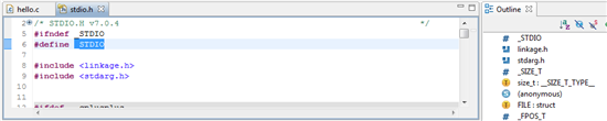

    For example in this code _STDIO is defined in stdio.h
    If I click on it and hit F3 it will open stdio.h and go the the correct line:
