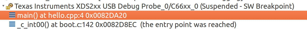

    Although whenever I try to load the Hello World program into one of the cores, it eventually gets stuck in the "Running" phase.

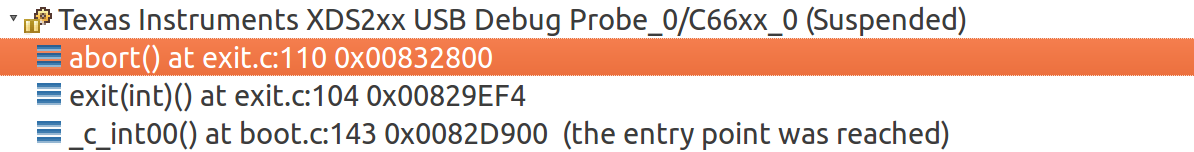

  • Hi George,
    Thank you for your help.
    I have successfully compiled my simple Hello World C++ code as shown below.
    #include <iostream>
    using namespace std;
    int main(void) {
        cout << "!!!Hello World!!!" << endl; // prints !!!Hello World!!!
        return 0;
    But when I try to run it on the DSP core, the console does not display any output.
    Did I miss any libraries to include or is there something wrong with my code?
    Or maybe I might have missed a configuration file during project creation?
    I hope you could help me with this.
    Madeleine
  • Please follow the suggestions in the article Tips for Using Printf.  In particular, I suggest you change your code to call puts instead.  That is much simpler.  But once you get that to work, it is likely the more complicated forms of printing will start to work.
    Thanks and regards,
    -George
