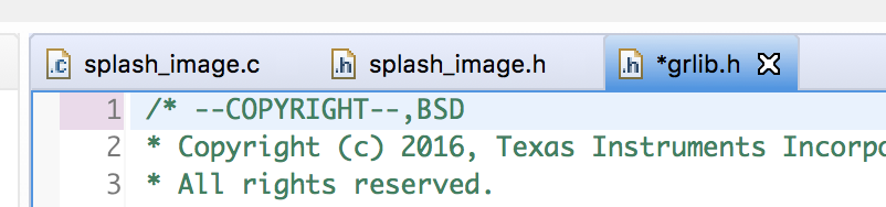

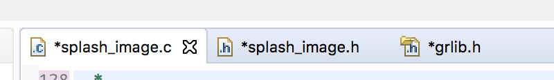

    For example here I have 3 files open in the editor.  All 3 are used by a project.  I dirty all 3 (note the *)
    I then build the project.  You can see that the first 2 got saved but not the last one:
    The difference between splash_image.h and grlib.h is that the first is in my project and the second is only referenced via a #include.

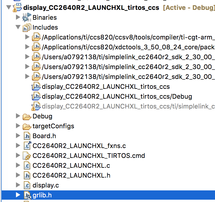

    If I add a reference to grlib to my project, note the little shortcut arrow on top of the file icon.  i.e. I didn't copy the file into the project just made a reference to it.

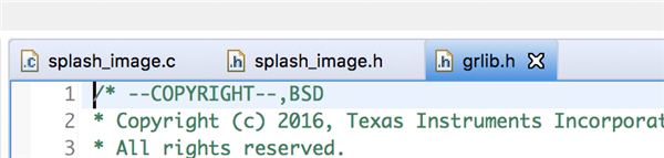

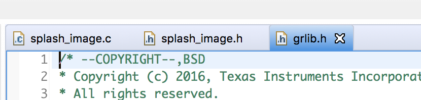

    Now if I open the file and dirty it:
    And then build:
    It saves the file.
