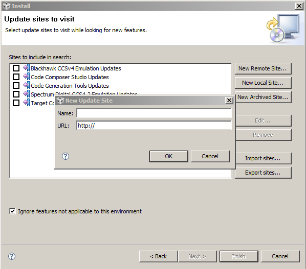

    Do you mean this?
    How should this actually be used (how to specify the URL if I need to update BIOS, XDC tools)?
    Sincerely
    Zheng
  • Zheng,
    That is the dialog you get when you click on the New Remote Site button.  Is it coming up automatically?  Seems odd that the Name would be blank since the name is showing up in the dialog behind it.
    The url for the Target Content Update Site is: http://software-dl.ti.com/dsps/dsps_public_sw/sdo_ccstudio/TargetContent/Updates/full/site.xml
