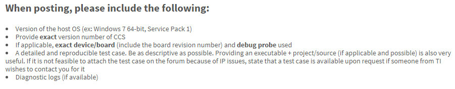

  • I am not a TI staff member.
    Quality of a question determines a quality of an answer.
    Garbage in, garbage out (gigo).
    Analyze startup script and refer to IPC related sections of the manual.
    Anytime you ask for help, please follow the first CCS forum rule:

    I didn't mean to be offensive and I never said your reponse was "garbage" nor did I expect you to be a staff member. I do appreciate your effort to help but please
    acknoledge that this effort is most effective when it relates to the question asked.
    It might well be that my question is garbage but in this case, I believe, it is not due to the lack of ceremony and red tape ( host OS, ) but rather to my lack of understanding of the PRU subsystem.
