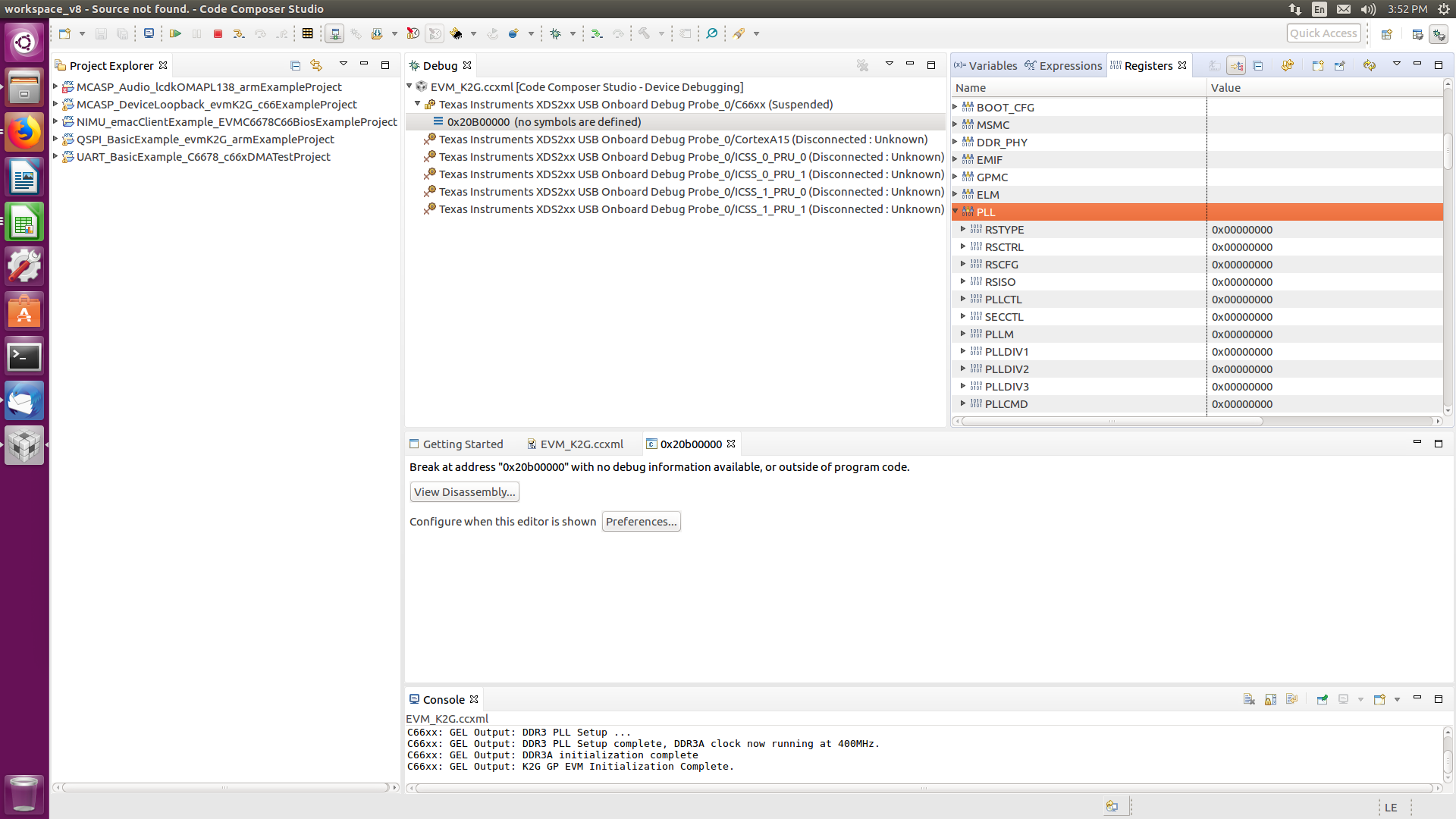

  • Hi Steve,
    Sorry for the late reply.
    Are you using the onboard XDS200 emulator?
    Before I connect to a core i was getting the same "error: unable to read". When I connected to the C66x core, I am seeing both PLL & SPI registers, see screenshots attached screenshots:
    Yordan
