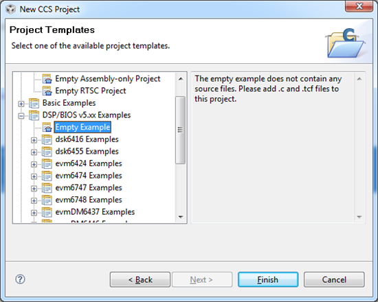

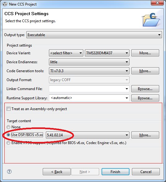

    However if your project is using the DSP/BIOS v5 operating system then it has to be setup as a BIOS project.  std.h is a BIOS header file.  If you want to have a BIOS project then please create a new project and indicate in the wizard that it will be a BIOS application.  This works a little different depending on if you are using CCSv4.1 or CCSv4.2.  The screen captures below show how to do this in each of the versions.
    For CCSv4.1 on the Project settings page of the wizard you need to select that it is a BIOS5 project
    For CCSv4.2 in the wizard you will need to select a DSP/BIOS 5 example template:

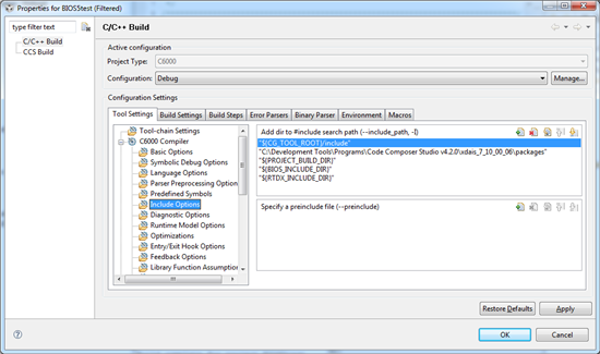

  • Reddy,
    You will need to add the include path for that file.  For me that is:
    C:\Development Tools\Programs\Code Composer Studio v4.2.0\xdais_7_10_00_06\packages
    Modify that path to match your installation directory and add it to the include paths specified in the build options

    after review of your reply , found one difference in my installed ccs IDE .
    In my installed version i did not find the options (whcih  is marked with rectaguler area in below fig.)
    could ypu please analyse  this aslo and help me.
    Reddy
  • Reddy,
    Yes there are different versions of the wizard.  If you are missing that area at the bottom when you click next you get a screen that allows you to select from a list of templates.  One of which is an empty BIOS5 project.
    When importing the examples you provided CCS doesn't seem to recognize them as BIOS projects.  I have filed a bug for that SDSCM00038741.
    I then created a new project using the project wizard and selected an empty BIOS5 project as the template.  I copied in the source code from firtest1.  I added the compiler include path for XDAIS and the include path for the "include" folder that was in the project.  I also added the libraries that were in the example and the include path for them.  After doing that I was able to build and link the project.
