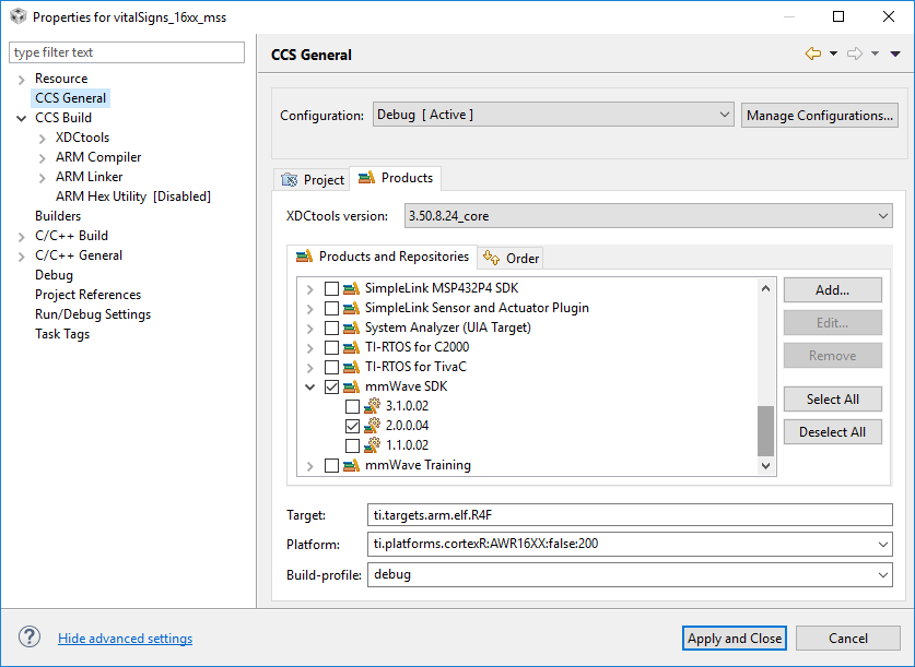

  • Please, deleate your project from the workspace with "Delete project contents on disk ..." marked ON.
    Then, import your projects again, switch mmWave SDK to version 2.00.00.04 and try to compile.
  • Yi,
    Is this issue resolved?
    I just confirmed that the lab project builds without errors with the following configuration:
    CCS 8.3
    mmWave SDK 2.00.00.04
    Automotive Toolbox 2.4.3
    Please follow the steps below and let us know if you still have problems.
    1) Open a new workspace in CCS
    2) From Resource Explorer (menu View->Resource Explorer), navigate to Driver Vital Signs lab, and import it into IDE
    3)  In Project Properties->Products tab, ensure the SDK version selected is 2.00.00.04.
    4) Build project.

  • Go to the www page link to which you have provided.
    Press "Get Software", go to the bottom and select "Link to previous release download page".
    Again to the bottom, than select "Link to previous release download page" and repeat that until you get a link to SDK v2.00.00.04.
  • Dear Tom,
    Thank you so much for patient answer,
    I pass the building as your guilding,
