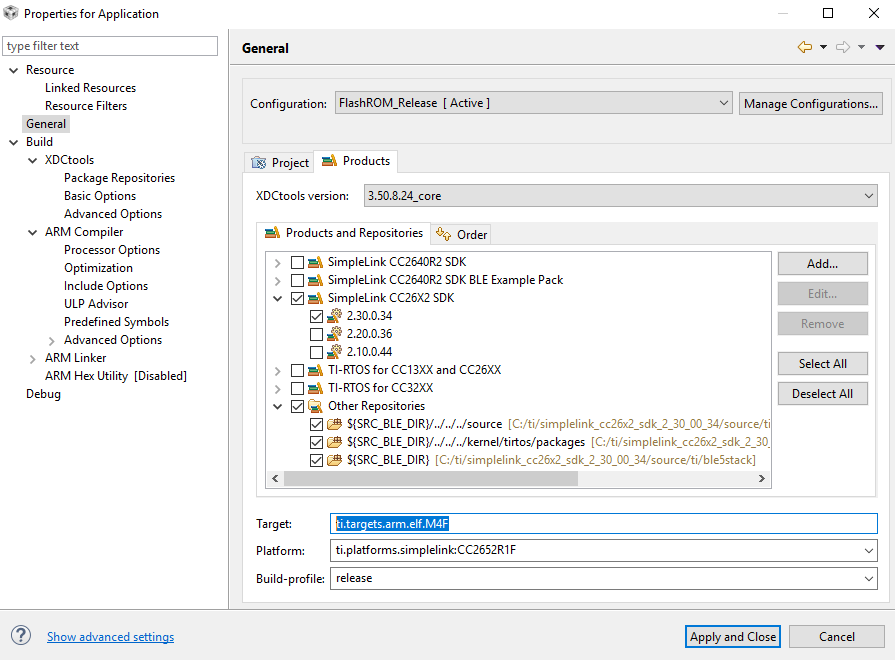

A customer of mine has issues with CCS when they try to use SDK 2.30.34 for the CC2652R and had to implement a work around.
The current work around is to change the 'target' under 'project properties':
General[Products]->Target: ti.targets.arm.elf.M4 -> ti.targets.arm.elf.M4F
(F stands for FPU)
Then the project works and it also works on the launchpad. This should not be necessary compared to the example project where it only says "ti.targets.arm.elf.m4"
What is the impact of this work around?
How can this issue be solved in the proper way?
Thank you for the support!
    The example projects in the SDK should have the correct setting of ti.targets.arm.elf.M4F. What we have observed is that if the Compiler Version for a project is changed in the Project Properties, then the Target field is incorrectly changed to ti.targets.arm.elf.M4. Is this what may have happened in the customer's case?
    If that is the case, they would need to manually set the Target back to ti.targets.arm.elf.M4F. This is being tracked in a bug report as per this thread
