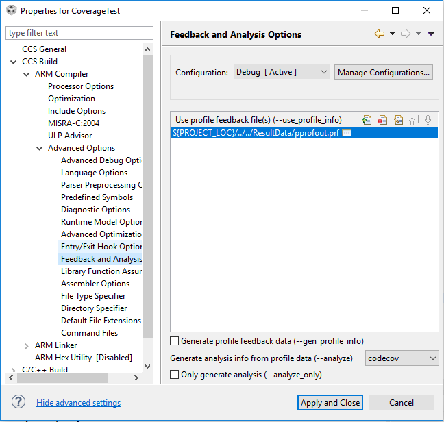

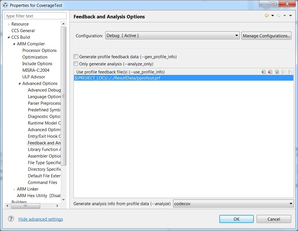

     Hello George,
    I tried what you show here and still no .csv files anywhere.
    Attached is a screenshot showing the config I used along with a file that contains the build commands that are emitted.
    Maybe you can send me the build commands that your build is emitting so that we can compare.
    Maybe we are using two different versions of compilers.  It does appear that we are using different version of CCS.
    Bob
  • Hi George,
    To let you know, after generating the pprofout.prf I modified it to remove all occurrences of the following text:
    C:\CoverageTesting\Workspace\CoverageTest\Debug/
    After doing this I am able to generate the .csv files which show up under folder:
    So for some reason when I run the following armcl command it puts the extra text that I removed in the .prf file, which I guess the compiler does not like when generating the .csv files.
    c:\ti\ccsv6\tools\compiler\arm_15.12.3.LTS\bin\armpdd -e CoverageTest.out -o pprofout.prf pprofout.pdat
    Thanks for the help,
    Bob

  • I discovered that I can reproduce this extra text in the .prf file ...
    ... if I use version 15.12.3.LTS to build the project, and then run armpdd with your pprofout.pdat file as input.  When I change the version to 18.12.0.LTS, and do the same thing, I do not get the extra text.  So, is it practical for you to upgrade to compiler version 18.12.x.LTS?
    Thanks and regards,
    -George
