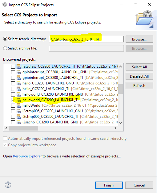

I have installed:
  1. CCS 8.3.0.00009
  2. CC3200SDK 1.3.0
  3. TI-RTOS for CC32xx 2.16.01.14
I have tried to import a project from TI-RTOS directory.

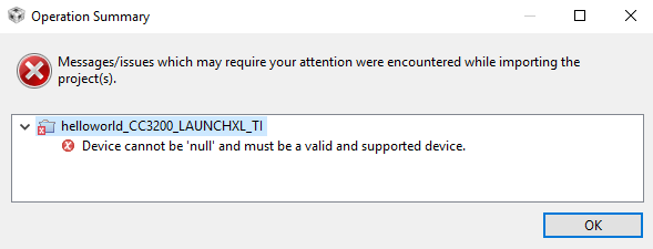

The CCS display the error:
Please your help with this error.
I have imported projects from CC3200SDK 1.3.0 without problem.
TIREX doesn’t recognize examples from CC3200SDK and TI-RTOS for CC32xx directories.
    For the older products like TI-RTOS for CC32xx, you would need to use Resource Explorer Classic instead of Resource Explorer, which can be opened from the CCS View menu. Please make sure that the TI-RTOS product is installed to CCS as described in this article. After that you should be able to import the examples directly from the Resource Explorer Classic interface.
    Hope this helps address the issue.
