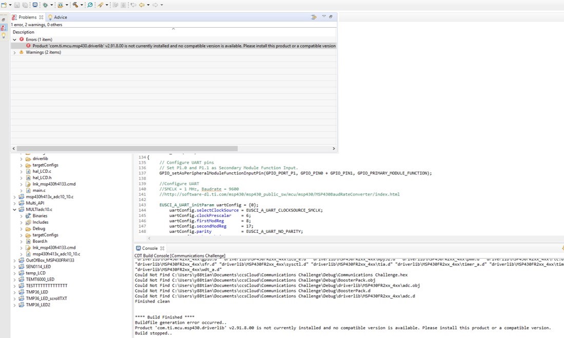

I am unable to build my project because of this error message. I can't find any information on how to resolve it. Has anyone gotten this before or know how to go about it? I'm on CCS Desktop version 8.3. Thanks.

    Your statement above and Console log are a bit inconsistent.
    Assuming that your ptoject is on CCS v8.3.0 desktop, issue is like this:
    Your project needs driverlib v2.91.8.00
    This lib is a part of the product called msp430ware v3.80.05.04
    The easiest way to install TI product I know is like this:
    1. go to View -> Resource Explorer
    2. find MSP430Ware, select v3.80.05.04, use an icon on the right to version number to download and install this product
    Build your project.
