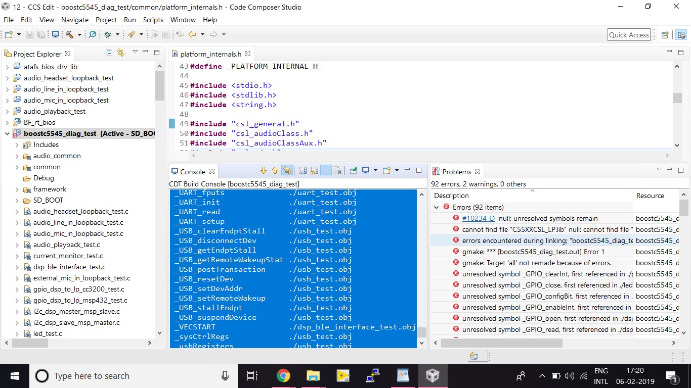

Hai all,
i am working on C5545 Booster pack and following C5545 BoosterPack Software User's Guide (www.ti.com/.../sprui92.pdf) , when i try to build ‘boostc5545_diag_test’ project i am getting below error
**** Build of configuration SD_BOOT for project boostc5545_diag_test ****
"C:\\ti\\ccsv7\\utils\\bin\\gmake" -k all
'Building file: "C:/ti/c55_lp/rollbackBackupDirectory/C/ti/c55_lp/c5545bp_software_01.01.00.00/source_code/c55xx_diagnostics/board/diag/audio_test/audio_headset_loopback_test/src/audio_headset_loopback_test.c"'
'Invoking: C5500 Compiler'
"C:/ti/ccsv7/tools/compiler/c5500_4.4.1/bin/cl55" -v5515 --memory_model=large -g --include_path="C:/ti/ccsv7/tools/compiler/c5500_4.4.1/include" --include_path="C:/ti/c55_lp/c55_csl_3.08/inc" --include_path="C:/ti/c55_lp/rollbackBackupDirectory/C/ti/c55_lp/c5545bp_software_01.01.00.00/source_code/c55xx_diagnostics/board/diag/i2c_dsp_msp_test/dsp_master_msp_slave/inc/" --include_path="C:/ti/c55_lp/rollbackBackupDirectory/C/ti/c55_lp/c5545bp_software_01.01.00.00/source_code/c55xx_diagnostics/board/diag/i2c_dsp_msp_test/dsp_slave_msp_master/inc/" --include_path="C:/ti/c55_lp/rollbackBackupDirectory/C/ti/c55_lp/c5545bp_software_01.01.00.00/source_code/c55xx_diagnostics/board/diag/rtc_test/inc" --include_path="C:/ti/c55_lp/rollbackBackupDirectory/C/ti/c55_lp/c5545bp_software_01.01.00.00/source_code/c55xx_diagnostics/board/diag/spi_flash_test/inc" --include_path="C:/ti/c55_lp/rollbackBackupDirectory/C/ti/c55_lp/c5545bp_software_01.01.00.00/source_code/c55xx_diagnostics/board/diag/oled_display_test/inc" --include_path="C:/ti/c55_lp/rollbackBackupDirectory/C/ti/c55_lp/c5545bp_software_01.01.00.00/source_code/c55xx_diagnostics/board/diag/gpio_dsp_to_lp_cc3200_test/inc" --include_path="C:/ti/c55_lp/rollbackBackupDirectory/C/ti/c55_lp/c5545bp_software_01.01.00.00/source_code/c55xx_diagnostics/board/diag/usb_test/inc" --include_path="C:/ti/c55_lp/rollbackBackupDirectory/C/ti/c55_lp/c5545bp_software_01.01.00.00/source_code/c55xx_diagnostics/board/diag/gpio_dsp_to_lp_msp432_test/inc" --include_path="C:/ti/c55_lp/rollbackBackupDirectory/C/ti/c55_lp/c5545bp_software_01.01.00.00/source_code/c55xx_diagnostics/board/diag/push_button_test/inc" --include_path="C:/ti/c55_lp/rollbackBackupDirectory/C/ti/c55_lp/c5545bp_software_01.01.00.00/source_code/c55xx_diagnostics/board/diag/led_test/inc" --include_path="C:/ti/c55_lp/rollbackBackupDirectory/C/ti/c55_lp/c5545bp_software_01.01.00.00/source_code/c55xx_diagnostics/board/diag/uart_test/inc" --include_path="C:/ti/c55_lp/rollbackBackupDirectory/C/ti/c55_lp/c5545bp_software_01.01.00.00/source_code/c55xx_diagnostics/board/diag/audio_test/audio_headset_loopback_test/inc" --include_path="C:/ti/c55_lp/rollbackBackupDirectory/C/ti/c55_lp/c5545bp_software_01.01.00.00/source_code/c55xx_diagnostics/board/diag/audio_common" --include_path="C:/ti/c55_lp/rollbackBackupDirectory/C/ti/c55_lp/c5545bp_software_01.01.00.00/source_code/c55xx_diagnostics/board/diag/audio_test/audio_mic_in_loopback_test/inc" --include_path="C:/ti/c55_lp/rollbackBackupDirectory/C/ti/c55_lp/c5545bp_software_01.01.00.00/source_code/c55xx_diagnostics/board/diag/audio_test/audio_playback_test/inc" --include_path="C:/ti/c55_lp/rollbackBackupDirectory/C/ti/c55_lp/c5545bp_software_01.01.00.00/source_code/c55xx_diagnostics/board/diag/audio_test/external_mic_in_loopback_test/inc" --include_path="C:/ti/c55_lp/rollbackBackupDirectory/C/ti/c55_lp/c5545bp_software_01.01.00.00/source_code/c55xx_diagnostics/board/diag/audio_test/audio_line_in_loopback_test/inc" --include_path="C:/ti/c55_lp/rollbackBackupDirectory/C/ti/c55_lp/c5545bp_software_01.01.00.00/source_code/c55xx_diagnostics/board/diag/sd_test/inc" --include_path="C:/ti/c55_lp/rollbackBackupDirectory/C/ti/c55_lp/c5545bp_software_01.01.00.00/source_code/c55xx_diagnostics/board/diag/dsp_ble_interface_test/inc" --include_path="C:/ti/c55_lp/rollbackBackupDirectory/C/ti/c55_lp/c5545bp_software_01.01.00.00/source_code/c55xx_diagnostics/board/diag/current_monitor_test/inc" --include_path="C:/ti/c55_lp/rollbackBackupDirectory/C/ti/c55_lp/c5545bp_software_01.01.00.00/source_code/c55xx_diagnostics/board/diag/framework/boostC5545/inc" --include_path="C:/ti/c55_lp/rollbackBackupDirectory/C/ti/c55_lp/c5545bp_software_01.01.00.00/source_code/c55xx_diagnostics/board/diag/common" --include_path="C:/ti/c55_lp/c55_csl_3.06/inc" --include_path="C:/ti/c55_lp/rollbackBackupDirectory/C/ti/c55_lp/c5545bp_software_01.01.00.00/source_code/c55xx_diagnostics/board/diag/" --include_path="C:/ti/c55_lp/rollbackBackupDirectory/C/ti/c55_lp/c5545bp_software_01.01.00.00/source_code/c55xx_diagnostics/board/diag" --define=c5545 --define=USE_SERIAL_CONSOLE --display_error_number --diag_warning=225 --ptrdiff_size=16 --preproc_with_compile --preproc_dependency="audio_headset_loopback_test.d_raw" "C:/ti/c55_lp/rollbackBackupDirectory/C/ti/c55_lp/c5545bp_software_01.01.00.00/source_code/c55xx_diagnostics/board/diag/audio_test/audio_headset_loopback_test/src/audio_headset_loopback_test.c"

'Building target: "boostc5545_diag_test.out"'
'Invoking: C5500 Linker'
"C:/ti/ccsv7/tools/compiler/c5500_4.4.1/bin/cl55" -v5515 --memory_model=large -g --define=c5545 --define=USE_SERIAL_CONSOLE --display_error_number --diag_warning=225 --ptrdiff_size=16 -z -m"boostc5545_diag_test.map" --stack_size=0x200 --heap_size=0x400 -i"C:/ti/ccsv7/tools/compiler/c5500_4.4.1/lib" -i"C:/ti/ccsv7/tools/compiler/c5500_4.4.1/include" -i"C:/ti/c55_lp/rollbackBackupDirectory/C/ti/c55_lp/c5545bp_software_01.01.00.00/source_code/c55xx_diagnostics/board/diag/build/boostC5545/diag_test" -i"C:/ti/c55_lp/c55_csl_3.06/ccs_v6.x_examples/C55XXCSL_LP/Debug" --reread_libs --display_error_number --warn_sections --xml_link_info="boostc5545_diag_test_linkInfo.xml" --rom_model --sys_stacksize=0x200 -o "boostc5545_diag_test.out" "./audio_headset_loopback_test.obj" "./audio_line_in_loopback_test.obj" "./audio_mic_in_loopback_test.obj" "./audio_playback_test.obj" "./current_monitor_test.obj" "./dsp_ble_interface_test.obj" "./external_mic_in_loopback_test.obj" "./gpio_dsp_to_lp_cc3200_test.obj" "./gpio_dsp_to_lp_msp432_test.obj" "./i2c_dsp_master_msp_slave.obj" "./i2c_dsp_slave_msp_master.obj" "./led_test.obj" "./main.obj" "./oled_display_test.obj" "./push_button_test.obj" "./rtc_test.obj" "./sd_test.obj" "./spi_flash_test.obj" "./uart_test.obj" "./usb_test.obj" "./audio_common/audio_common.obj" "./common/i2c_probe.obj" "./common/platform.obj" "./common/system_init.obj" "./framework/boostC5545/src/diag_config.obj" "./framework/boostC5545/src/framework.obj" "C:/ti/c55_lp/rollbackBackupDirectory/C/ti/c55_lp/c5545bp_software_01.01.00.00/source_code/c55xx_diagnostics/board/diag/common/C5545BP.cmd" -llibc.a -lC55XXCSL_LP.lib
<Linking>
error #10008-D: cannot find file "C55XXCSL_LP.lib"
undefined first referenced
symbol in file
_GPIO_clearInt ./push_button_test.obj

showing 92 errors in problem window (attached) , please guide me through this
thanks in advance
Hussain
  • Hussain,
    When you get a lot of errors like that focus on the first ones. When building an early error often causes many others.
    The key error is "Cannot find file C55XXCSL_LP.lib". Basically your project includes a library but the build system is not able to find it. This is what is causing all of the unresolved symbol errors since the application code is calling APIs in that library.
    Look for C55XXCSL_LP.lib in the software that you downloaded from TI. It is not something that comes with Code Composer Studio but would be part of the software that you downloaded for the booster pack.
    Once you have located the library you need to add the path to the linker library search path. Open the properties for the project. Expand Build -> C5500 Linker -> File Search Path in the tree on the left. Add the location of the library to the library search path.
    John
