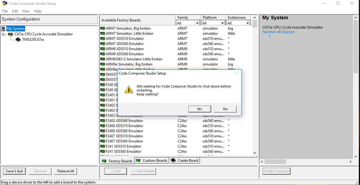

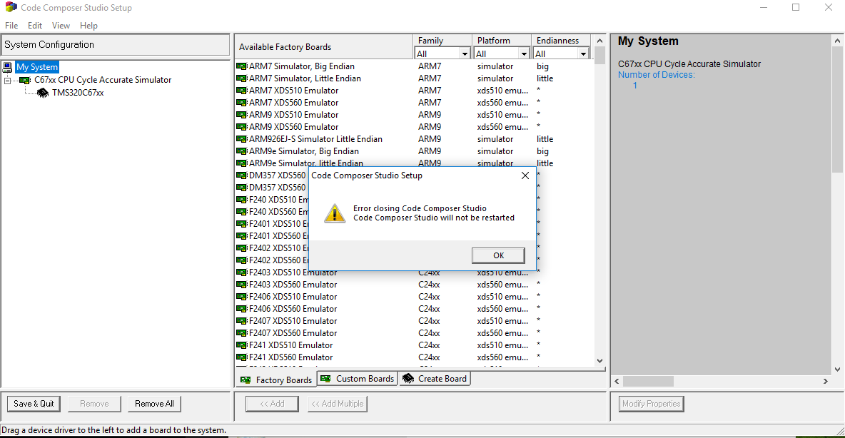

Hi guys, I am facing this issue when i set the  target and trying to move on for opening a window to code, this issue is stopping the software CCSv3.3.83.20. I need your help in solving this problem ASAP. THanks
  • Looking at your other post, I am assuming you are using Windows 10. Please see my comments in that post regarding CCSv3.3 and Windows 10 support.
    If you insist on trying to run in on Windows 10, make sure both cc_app.exe and cc_setup.exe in C:\CCStudio_v3.3PLA\cc\bin have permission to run as administrator and also configured to run in Windows XP compatibility mode.
