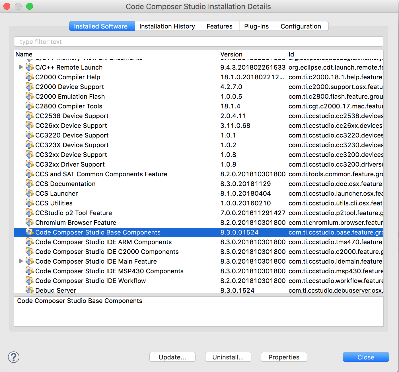

  • It is the "TI Emulators" update that is adding that update site. I have a defect filed to get it fixed.
    I would not worry about the version number being blank in that location as long as the version number is still correct in the installation details here:
    John
