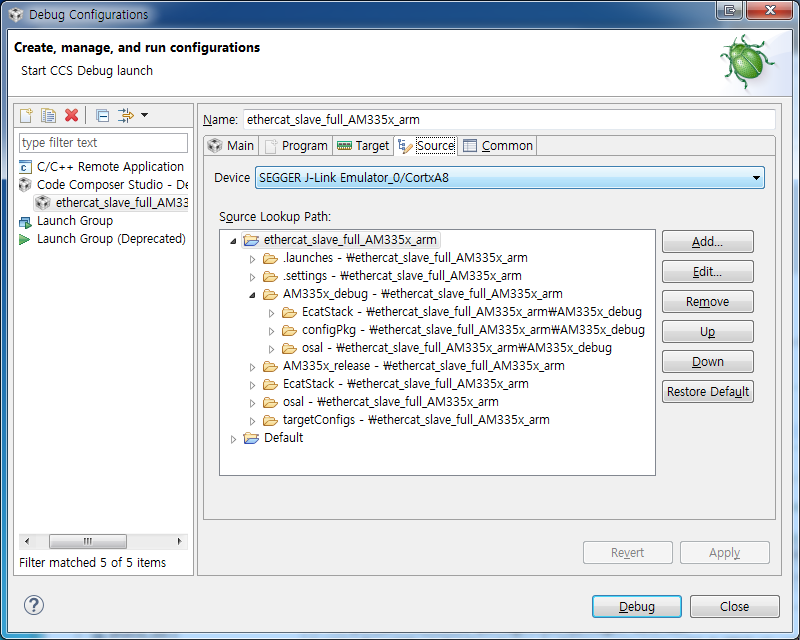

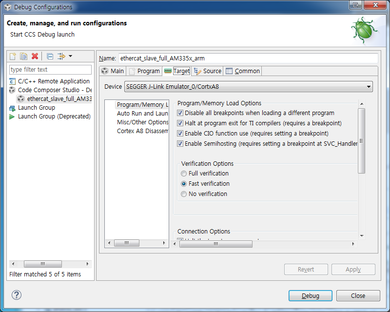

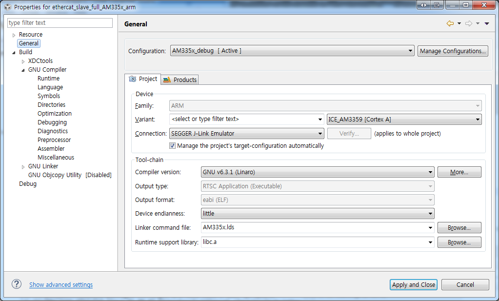

1. I Run CCS and Project - Import CCS Projects - ethtercat_slave_full Project
2. Environment Screenshoot
 2.1 Properties for ethercat_slave_full_AM335x_arm

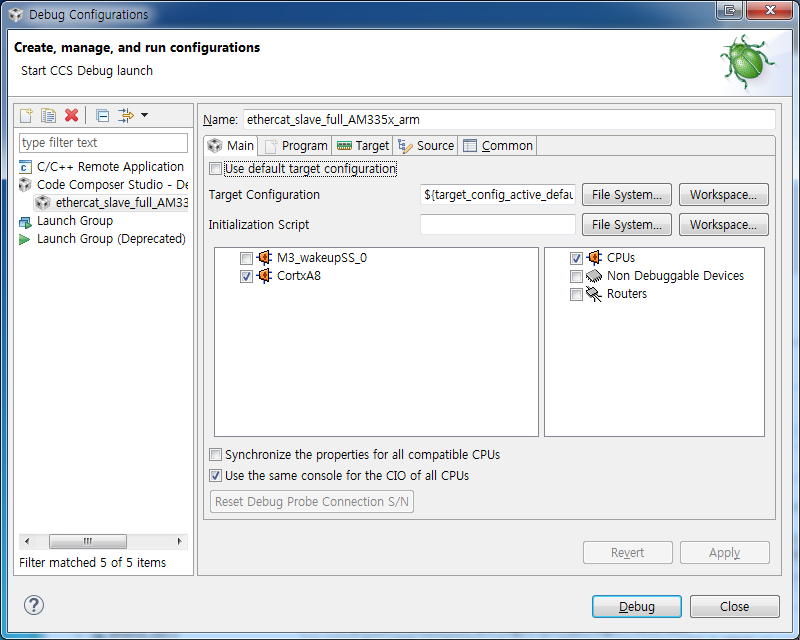

 2.2 ethercat_slave_full_AM335x_arm Debug Congigurations
  2.2.1 Main
  2.2.2 Program
  2.2.3 Target
  2.2.4 Source
  2.2.5 Common

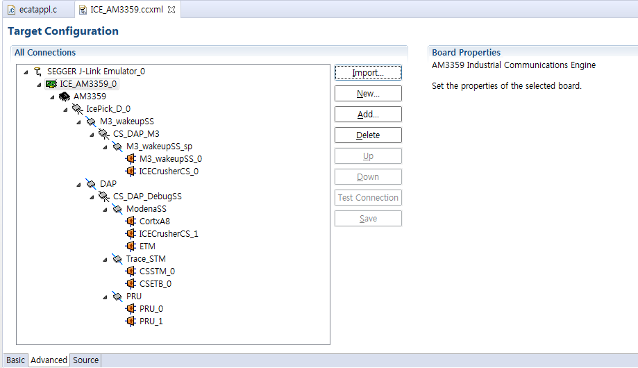

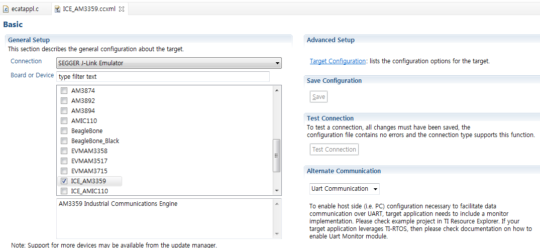

 2.3 ICE_AM3359.ccxml TargetConfigs
  2.3.1 Basic
  2.3.2 Advenced

 Q1. Is Environment properly set up?

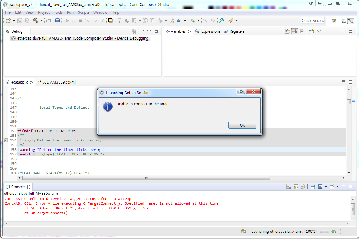

 Q3. Running the Debug Session will result in the following error. How do I fix errors?

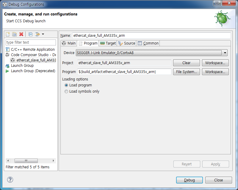

 Q4. I built the ethercat_slave_full_AM335x_arm and got the following files: How to download images to AM3359ICE2?
  ethercat_slave_full_AM335x_arm.bin / ethercat_slave_full_AM335x_arm.map / ethercat_slave_full_AM335x_arm.out

    Thanks for the very detailed post. Answering your questions:
    Q1 .The configuration seems ok.

    Q3. The error message in red indicates the device is not responding to the requests from the Debug Probe, therefore it may be locked up due to pre-existing running code on the board (a common feature of the AM335x ICE boards, given they come pre-flashed with demonstration code).
    You can try to change the boot modes of your kit to prevent the board from booting from its internal flash, thus allowing the JTAG communications to properly work. Please refer to the board user's guide.
    Q4. The last screenshot indicates you are following a proper procedure. The file that is loaded via CCS is the one that has the .out extension.

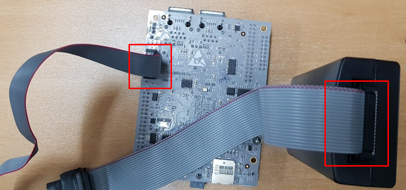

  • Thank you for your response.
    I have additional questions.
    Q1. Does the board user guide mean HW_User_Guide?

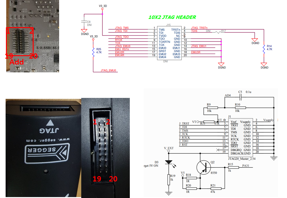

    Q2. Is the following hardware configuration correct?
    Q3. How to download images to AM3359ICE2 with J-Link in CCS?
    in advance thank you very much.
    I don't have the exact same ICE board as you (mine is Rev 1), but I am still retrofitting it to get the cTI 20-pin connector so I can test it thoroughly.
    One detail: I can tell from your last picture that you have a very long cable - I wonder if it may be introducing some noise or excessive delays in communications. Also, make sure the pinout matches the table in the reference below:
    http://dev.ti.com/tirex/#/?link=Development%20Tools%2FDebug%20Probes%2FXDS%2FDocuments%2FJTAG%20Connectors
    I will have additional details tomorrow when I finish the rework on my board.
    Rafael

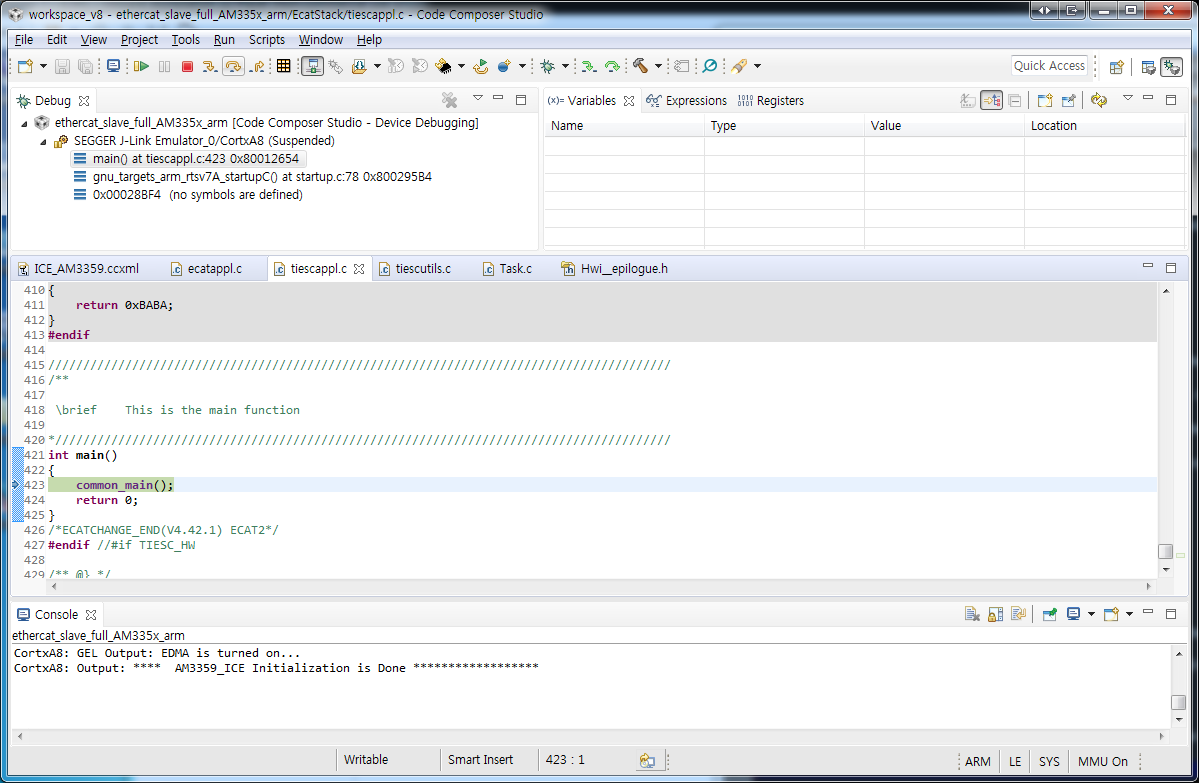

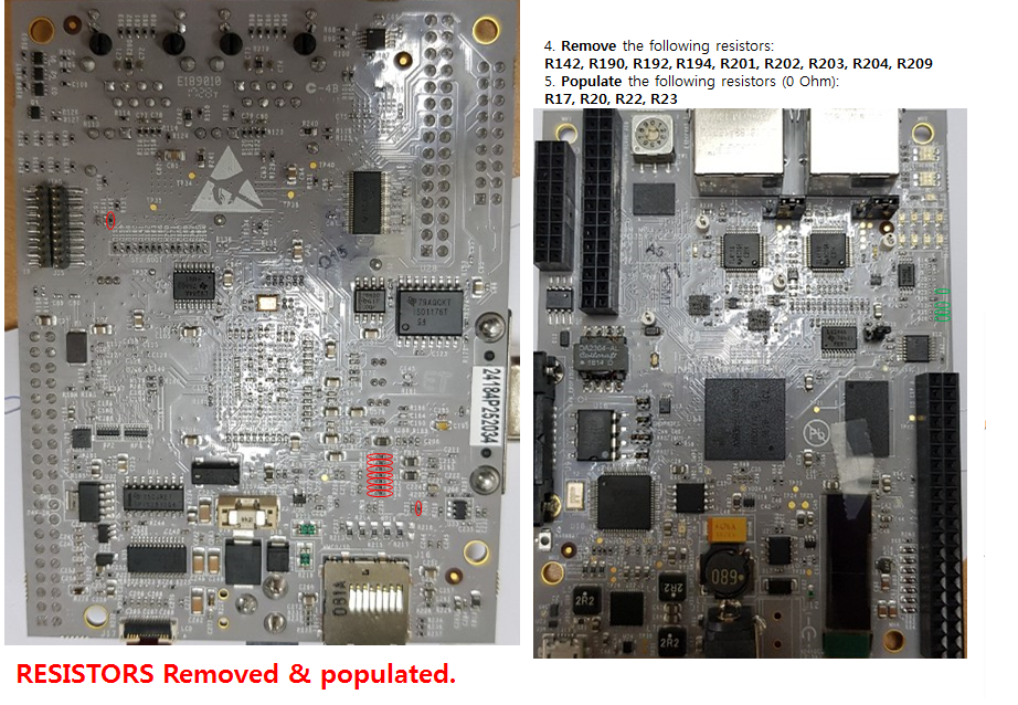

  • Hi.
    I sincerely appreciate your information.
    dev.ti.com/.../
    After referring to the above URL, debugging is possible as follows
    Next I want to download to the AM3359 board.
    What should I do with CCS?
