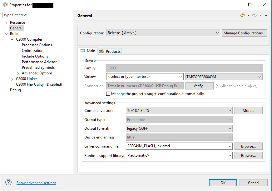

  • The TI compiler version is not the same as the CCS version, as one version of CCS can deal with multiple versions of the compiler installed at once.
    To quickly find the TI compiler version:
  • That version is TI v18.1.3.LTS as shown below for the F280049 which is also for the F28379D having the same issue:
