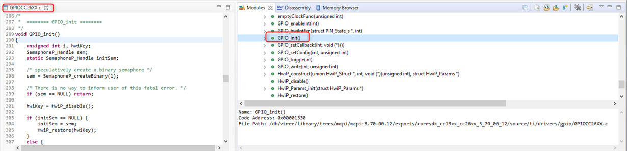

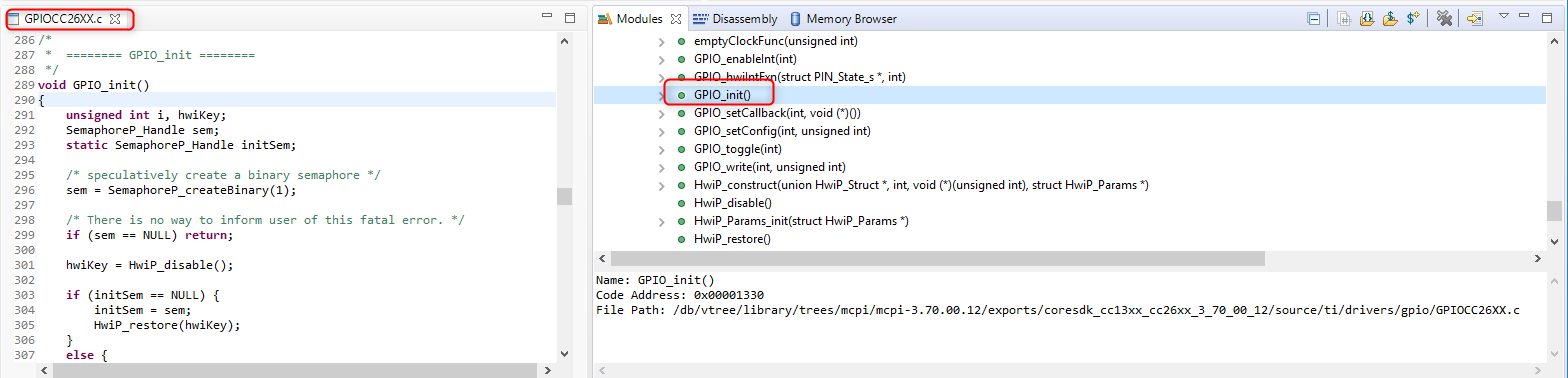

    If you highlight the function call in the editor and press F3, CCS should jump to the declaration of the function. For example, Board_initGeneral() is declared in Board.h, which is defined as CC2640R2_LAUNCHXL_initGeneral(). Pressing F3 on that will jump to the the declaration in CC2640R2_LAUNCHXL.c.
    You can also always use the Modules view to browse the debug symbols. Under 'Functions', you can look for the function of interest and double-click on it to open the source file in the editor:
