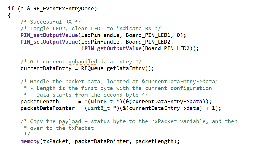

Referencing the TX/RX echo example for a cc1350, would it be possible to only echo back a packet only after receiving a specific packet
My current code makes my rx echo to any signal it picks up.
  • This question is answered in e2e.ti.com/.../780378
  • Hi i cant reply on the other thread,
    So i do hope you can help me here!
    This is my code and i hope you can show me where i can insert the if rxpacket=packetiwanttoreceive

  • The same place as commented in the original post:
    "memcpy(txPacket, packetDataPointer, packetLength); copies the content of the received packet into the txpacket. If you don't want to do this you have to skip this line and set txpacket to the data you actually want to send."
    You can add a if statement here.
  • /* Successful RX */
    /* Toggle LED2, clear LED1 to indicate RX */
    PIN_setOutputValue(ledPinHandle, Board_PIN_LED1, 0);
    PIN_setOutputValue(ledPinHandle, Board_PIN_LED2,
    !PIN_getOutputValue(Board_PIN_LED2));
    /* Get current unhandled data entry */
    currentDataEntry = RFQueue_getDataEntry();
    /* Handle the packet data, located at &currentDataEntry->data:
    * - Length is the first byte with the current configuration
    * - Data starts from the second byte */
    packetLength = *(uint8_t *)(&(currentDataEntry->data));
    packetDataPointer = (uint8_t *)(&(currentDataEntry->data) + 1);
    if (rxPacket[0]= "00SITFYPSEARCH" )
    txPacket[0] = (uint8_t)(0xAA);
    It still echoes to any signal :/
  • txPacket[0] is one byte meaning that it could never by equal to a string that is more than a byte long.
  • so how should i modify my code?
    sorry for bothering you though
  • The question you have now if basically a 'c' question. This forum covers how to use our devices but we don't have the bandwidth to cover programming specific questions.
