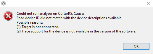

We are trying to use the hardware tracing capability of the XDS200 debug probe, following the Trace Analyzer User's Guide (Rev. B): http://www.ti.com/lit/ug/spruhm7b/spruhm7b.pdf
I believe that our chip (TMS570LC4357) should support hardware tracing, according to the technical reference manual (TRM) as well as the chip datasheet. However, after initializing the configurations for the different hardware trace analyzers, and upon launching the "Code Coverage" analyzer, I get the following error message:
I'm confident that I have the XDS200 probe connected properly to our Launchpad, as I can successfully flash and step through the application code, and my version of CCS is 8.1.0.00011.

  • James,
    The XDS200 is not a trace receiver. It supports SWO, which is a serial trace on Cortex M devices and it supports reading trace output from an embedded trace buffer (ETB).
    The TMS570 device you are using has ETM trace capabilities. It does not have an ETB so for this device the trace data is exported directly over pins. To support that you need a full trace receiver such as the TMDSEMUPROTRACE. That is a bit of an investment.
