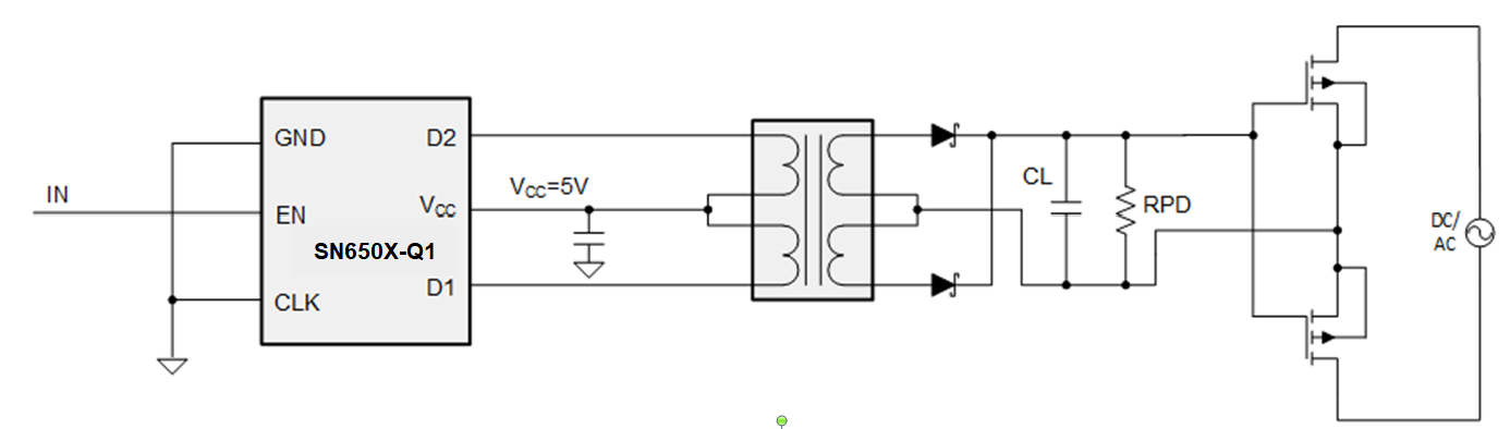

    If no of Relay operations are more than recommended by manufacturer it will definitely pose a threat for safety in BMS. There are multiple ways of replacing mechanical small signal relay with semiconductors. Here is one example for the same.
    SN6501-Q1,SN650X-Q1 can be used  for driving power relay, Relay can be selected based on isolation requirements for the switch. Rpd will help in discharging the gate- source capacitance during turn off of the system.

    But, my question is just how to replace the mechanical relay
    because the mechanical relay is not good for the frequent testing.
    SSR seems not to be good because the voltage will be very high for the turn_off case.
    Kim

    Replacing Mechanical Relay:
    1) In case of SSR, Turn off withstanding voltage is definitely an important design challenge. Care must be taken in choosing the right switches (high Vds during turn off), series resistors(>700Kohms) for the given "turn off state withstanding voltage" requirement.
    2) Considering safe leakage current from OEM/market, maximum battery voltage an high ohmic resistors(>2Mohm) can be chosen to connect high voltage battery connections and chassis ground.Note: Testing mechanism of TIDA-01513 cannot support this circuit. Check with compliance and safety team before implementing the same.
    If the physical separation of isolation contact is mandatory, then it is recommended to check for high reliability small signal relays. There are couple of manufacturers of small signal relays who support high number of relay operations(ideally targeting this application). Do contact your local support/supplier team of small signal relays, they might have better options/recommendations to support this challenge with small signal relay.
