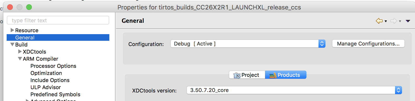

  • Yeah it looks a bit funny when we have similar language for other families like MSP430.
    CCSv9 ships with XDCTools 3.55. Looks like this software package wants an earlier version of XDCTools. You can change the project to use an older version.  Assuming it has discovered them. I would take a look at v8 and check which version of XDCTools is being used by the project there.  Then in CCSv9 you can change the project properties to use that version here:
    If the version you are looking for does not show up in the list then we will need to make CCS discover it.
    You can do that in the preferences dialog here:
    Just add the path in the top part of the dialog and then click the rediscover button.
    John

    I have rediscovered older xdctools from parent directory and after few more shaman moves finally I was able to build my project.
