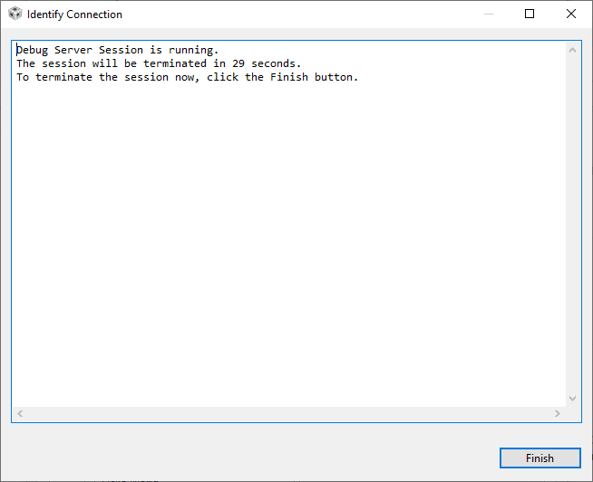

    Also when I click the "Identify" button, there's a "Starting Debug Server" window popping up, and then the entire CCS is halted ( on which I can't click or type anything).
    Do you have an actual MSP430 board or FET plugged into your PC? It is trying to identify it. If it finds it, it will blink an LED.

    I plugged MSP-FET & MSP-EXP430F5438 board to my laptop and tried to create a new CCS project as seen below, but the CCS still didn't find both my FET & EXP board, and was halted again, forcing me to terminate CCS from task manager.
    I using the same CCS version with the same MSP-FET & MSP-EXP430F5438 target (the device on the kit is an F5438A). The Idenitfy button works - it blinks the LED on the MSP-FET and then a message appears about terminating:
    What happens when you build the project and try to start a debug session for it? Is the debugger able to connect to the target?
