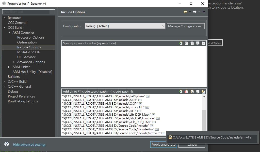

The program is at loop0 and CCS cannot open the file.
The reason that CCS cannot open the file is because the path is wrong.
There actually have a file called exceptionhandlr.asm, however, its path is ccsv8 rather than ccsv6.

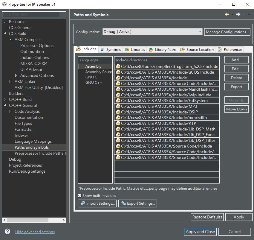

I go checked the include directories and include options under project's properties. No letters "ccsv6" appears.
How come this letters come up? And how can I change it to ccsv8?
Last, where can I adapt the symbol ${CCS_INSTALL_ROOT}?

    Is it possible that the project is linking in a library that was created using source files from the ccsv6 path? If so, the debug information in it will point to source paths at the time the library was built.
    Take a look at this page about Debugging Library code: http://software-dl.ti.com/ccs/esd/documents/users_guide/ccs_debug-main.html#debugging-library-code
    You can try clicking the Locate File button and browse to the correct location of the file. The above page also mentions a couple of other ways to tell the debugger where to look for sources that are not part of the project.
    Hope this helps.
