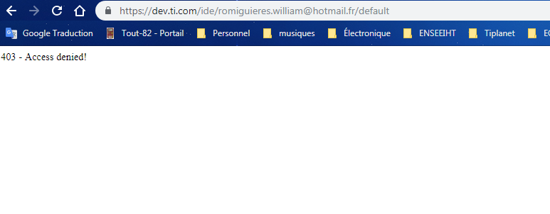

a few weeks ago, I worked on a project with my LaunchPad MSP401R , on the online CCS IDE (at https://dev.ti.com/ide/ )
Unfortunately, today I wanted to work agin on this project, but when I tried to access the IDE, I got a 403 error with "access denied" message.
Strangely, the email address in the url is the old email address of my TI account, that I changed a few months ago.
And when I try to disconnect / reconnect, my old email does'nt seem recognized, and my new mail redirects me to an empty workspace on CCS Cloud.
I guess there is a workspace conflict because of email addresses.
Will it be possible to regain access to my documents?
Thank you so much.
Wistaro.

  • Hello Wistaro,
    Can you go to my.ti.com and change your e-mail to your old e-mail?
    After that go to dev.ti.com, login with the old e-mail and see if you can access your old workspace.
    If yes, you can select a project in the left pane, then select a context menu "Download Project..." and have that project downloaded to your local drive.
    After you switch your account to your new e-mail, you can upload the projects to your new workspace with the main menu "Project/Import CCS Project...". In the dialog select the "local..." button and browse to the location in your local drive.
    Let us know if that helps.
    Dobrin
    Yes, it worked, thank you very much!
