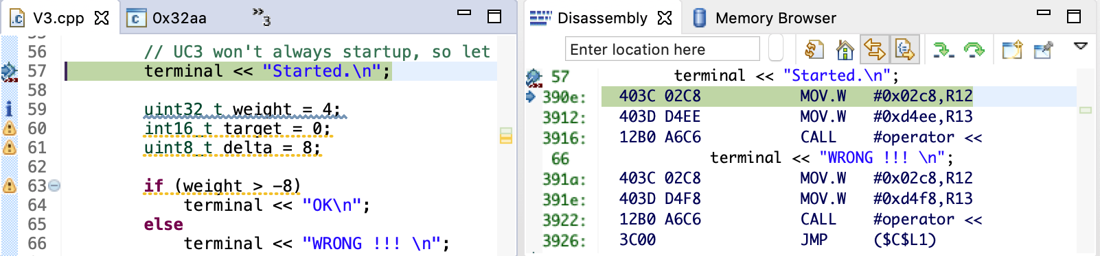

If I simplify even further:
      if (weight > -8)
           terminal << "OK\n";
       else
            terminal << "WRONG !!! \n";
The compiler even removes the test, assuming it's wrong (see picture below).
I assume there's a type mismatch issue here, but I have not been able to obtain a correct result.
