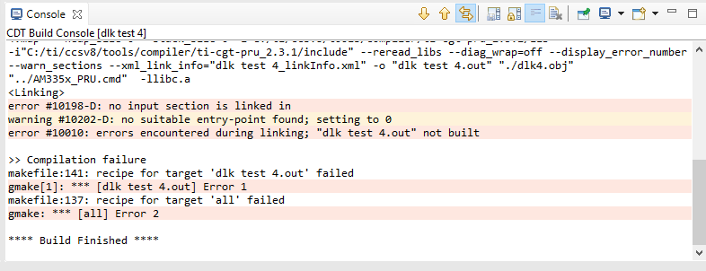

    Thanks for help.  Making progress but still getting errors.
    Removing line 10 did eliminate the error I was getting but I am still getting "error 10198-D: no input section is linked in".  I also get the warning you mentioned "10202-D: no suitable entry-point found; setting to 0".  Researching these on the web I found two relevant references:

  • David Kent1 said:
    I tried the suggestions for error 10198-D but those did not eliminate the error but at least I didn't get any new errors.
    adding the two directives (.retain and .retainrefs) should have gotten rid of the error. Can I see you asm file?
  • Ki,
    Here is the assembly code.  Also screen capture of the errors at end.
    David.

  • Thank you. I think the issue is having those two assembler directives on the first column (normally reserved for labels).
    yes, this seems to be the case. Please see section 4.5.2 of the below user's guide:
    http://www.ti.com/lit/ug/spruhv6c/spruhv6c.pdf
    ki
  • That did it, thanks!
