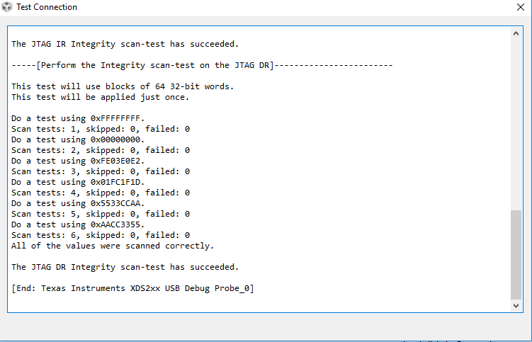

UniFlash 3.4 with USB2000 CONTROLLER
Controller: TMS320F28379S
We use the following command line:
-verbose 1 -log my_log1.txt -programStatusOutput my_log2.txt OK FEHLER -ccxml myConfig.ccxml -setOptions Z1LINKPOINTER1=1FFFFFFE Z1LINKPOINTER2=1FFFFFFE Z1LINKPOINTER3=1FFFFFFE Z1GRABSECT=3FFFFF55 Z1CSMPSWD0=00120034 Z1CSMPSWD1=00340056 Z1CSMPSWD2=0078009A Z1CSMPSWD3=00BC00DE -operation Z1LINKPOINTERProgram Z1GRABProgram Z1PasswordProgram -program my_program.srec
After this i´m not able to connect to the controller at all with the USB2000 CONTROLLER.
Is there a wrong command or option i´m using?
Is it possible to set options and operation with using program in one command line?
Stefan

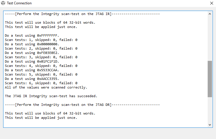

sterie said:After this i´m not able to connect to the controller at all with the USB2000 CONTROLLER.
Do you mean that you are unable to have UniFlash/CCS communicate to the USB2000 JTAG probe? Or that you are unable to have UniFlash/CCS communicate to the F28379 via the USB2000 JTAG probe?
ki
Hello Ki,
I´m unable to have UniFlash/CCS communicate to the F28379 via the USB2000 JTAG probe, at all.
