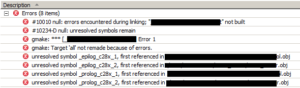

I'm trying to compile with size optimizing options, but whatever size optimization I try, the linker fires these unresolved symbols.
 I can't get why the linker seems doesn't find them only if i set optimization.
How can i solve ?
Thanks in advance.
  • Those symbols are functions defined in the compiler RTS library, which you must include in your link.  For details, please search the C28x compiler manual for the sub-chapter titled Including the Run-Time-Support Library.  When you first create a project in CCS, this configuration detail is normally handled automatically. I'm not sure how things went wrong.
