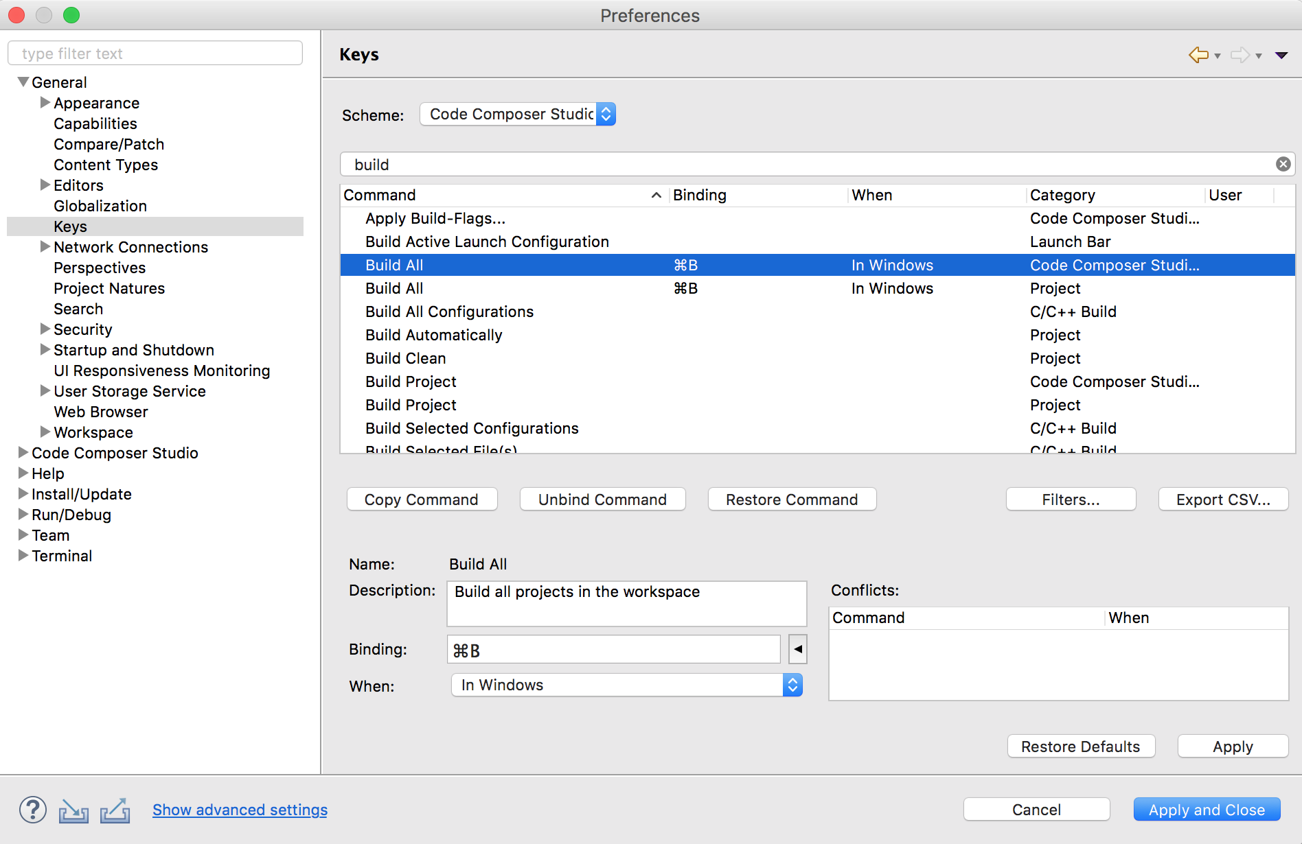

  • Nima,
    One thing you can do is you can change the keyboard shortcut associated with Build All.
    If you go to the preferences dialog and under General select "Keys", you can then change the keyboard short cuts.
    We are not able to insert a confirmation dialog.
    John
