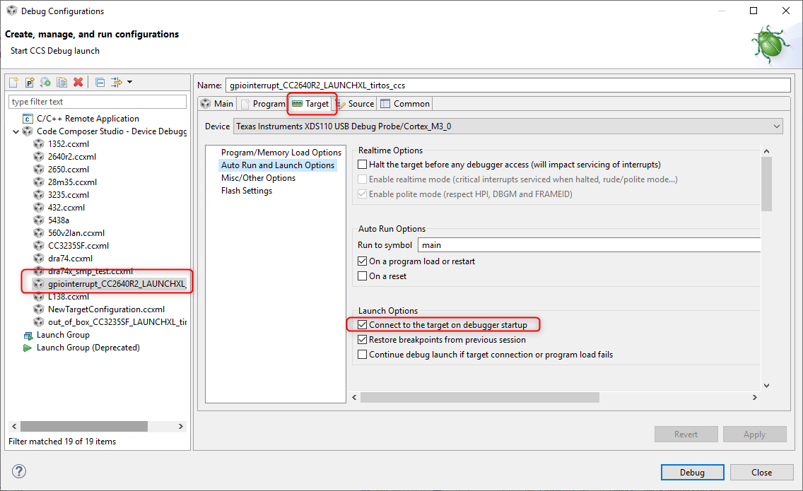

Anyways now with v9.0.1, it fixed this problem I was having with v8.3 only to run into another problem where the debug button no longer works.  Now when I press the debug button to download my program and take me to main, I get the following message in the console window of CCS:
Texas Instruments XDS110 USB Debug Probe/Cortex_M4_0 : Target must be connected before loading program.
To get around this problem, I now have to explicitly launch the .ccxml file, connect to the board and then download the program as 3 separate steps instead of this automatically occurring by pressing the debug button.  This was working before and then somehow someway it got into this mode and it's doing it on all my Simplelink processors (i.e, CC1352, CC3220, CC3235, etc) now.  Do you know what could have caused this and more importantly how to fix it?  Please advise.
Tim
  • Hi Tim,
    Please check the debug configuration for the project and see if the option to autoconnect on launch is still enabled. You can get to the list of debug configurations via: Run -> Debug Configurations...
    Then check the below option:
    ki
  • Hey Ki-Soo:
    Yes, that fixed it - thanks.  And thanks for the quick response.  I have no idea how it got into that mode and that checkbox got unchecked. I know I didn't do it, but thanks for a quick fix and knowing how to get out of this mode if it happens again.
