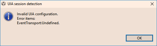

The project builds and executes, but when I try to boot up the System Analyzer, I get the following error message.
The XDC tools GUI shows my event upload mode as JTAG Stop Mode.  Is this simply unsupported with this version of UIA?

    3. Can you re-post the picture. It did not saw up.
    4. If it is a warning message, what happens if you ignore it and try to open it anyway.

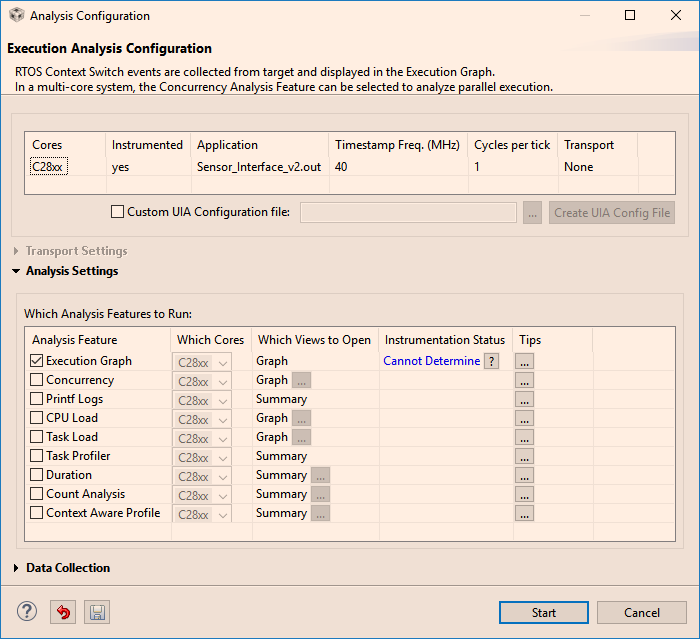

    3.)  Notice the Transport column is empty, I'm reasonably confident this is the problem.
    This message occurs after I click past the "Unable to determine instrumentation" popup.
    4.) If I close the message, UIA does not launch.

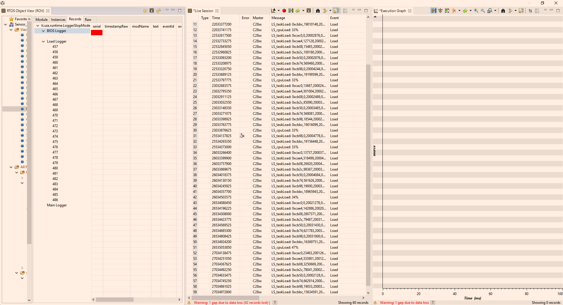

  • Thanks Todd.  I can now launch UIA.  I'm getting Load records, but nothing for SYS/BIOS logging aside from 1 dropped event.  Attached is a screenshot.

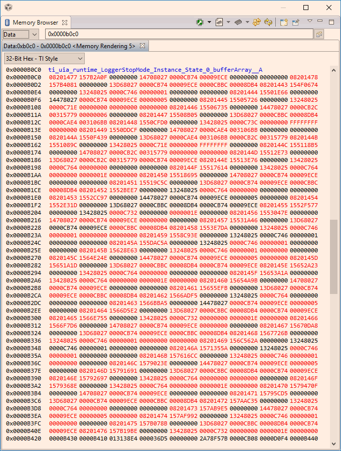

    I can certainly see data at that location in the Memory Browser, and the binary file for the memory section from 0x208000 to 0x210000 is attached.  loggerBuf in xintf.zip
  • Hi Luke,
    The header information (first 4 32-bit words) in the zip does not look correct. Can you compare it against when you have the log buffer in internal memory. I don't have access to a C28 right now (working remote today), but here is one for a 32-bit CortexM3. The first 4 words have information that CCS (and ROV) uses to figure out whether it is big or little endian, core id, length of buffer, etc. After those words, the Log records are encoded (e..g 0x50200300 -> a specific Log id and the length is 0x20 bytes. When you look at 0x20 bytes latter, there is another log record of 0x20 bytes. I cannot remember how much different this looks on the C28 with the 16 bit bytes. I'm hoping when you compare the internal verses external RAM, something pops up. Quick sanity check...do you do any type of memory tests on the external RAM?

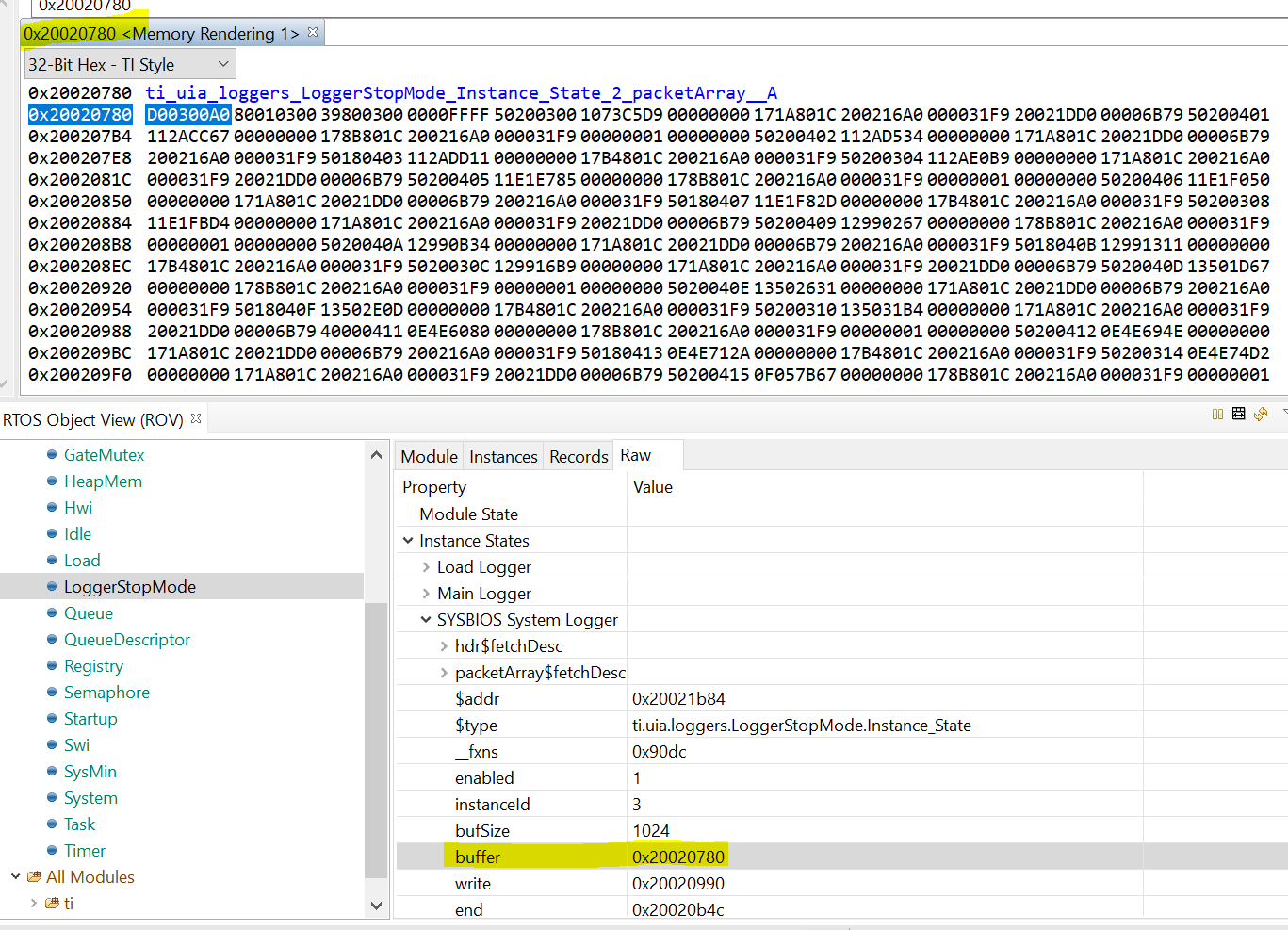

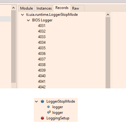

    I've moved the loggerBuf to on-chip memory and it works, screenshots attached.  First is evidence of the records.  I also included what appears to be two logger instances.  I've only set one up, and the second is unselectable in the XGConfig script.  Unsure if this is relevant or expected.
    Next is the buffer in the Memory Browser.  (I'm using the entry in ROV for the BIOS Logger's "queueStartAdrs")  The headers don't look quite the same but the records work and fill out the execution graph beautifully so I assume they're as expected.

  • The two logger instances (and one locked) has me a little worried...can you attach your .cfg?
  • 17316.app.cfgSure thing.  Attached is a doctored .cfg
  • I sent you a friend request. Let's work this offline and then update the thread when we have it figured out.

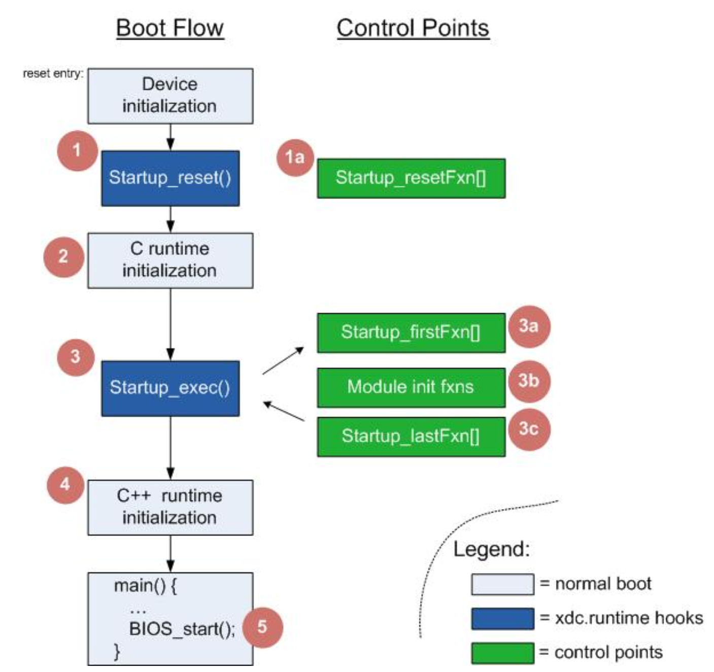

  • We found the issue. The external RAM was being initialized in main() before BIOS_start. LoggerStopMode does initialization before main though:( Namely it initializes the buffer header so CCS can read the buffer (e.g. what is the endianess, size of the buffer, etc.). That header was garbage since the memory had not been initialized yet.
    The fix was to add a Startup.firstFxn (3a below) which is called before the kernel's startup functions (3b below). We could have done a resetFxn (1a) instead, but that's a little trickier since there is no C runtime stack at that point (so no function calls, no local variables, etc.).
    Here's the syntax to add the startup functions
          var Startup = xdc.useModule('xdc.runtime.Startup');
          Startup.resetFxn = "&myResetFxn";
          Startup.firstFxns[Startup.firstFxns.length++] = "&myFirst";
          Startup.lastFxns[Startup.lastFxns.length++] = "&myLast";
    You can look at ROV->Startup->Module->firstFxns to see the firstFxns (you need to hit click in the box and select the drop-down).
    Luke added a firstFxn that initialized the external memory and the execution graph is working now...yea!!
