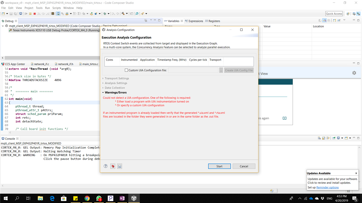

When I try to execute the "Execution Analysis" I get the following
How can I solve this issue?
I have seen other related, but not working.
This is CCS9
This is CCS9
When this type of message appears, it usually means that UIA instrumentation is not enabled in your configuration (.cfg) file. Please see Section 5.1 of the System Analyzer User's Guide that tells you how to enable UIA instrumentation. You can also use the stairstepStopMode example from the Simplelink SDK as a reference. The example is under the TI-RTOS Kernel examples. This example exercises the Execution Graph and will show you how the required instrumentation is enabled and configured so you may follow the same steps in your own project.
Hope this helps.
