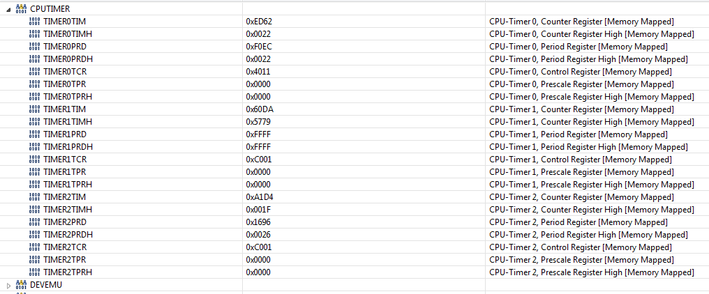

I have come across an issue with a project that I compiled with two different versions of code composer, one on my desktop and one on my laptop.
I started on my desktop which is running:
Code composer 5.4.0.00091
Compiler v6.2.11
Sys/Bios 6.35.1.29
On the laptop I have:
Code composer 5.5.0.00077
Compiler v6.2.11 (same)
Sys/Bios 6.35.4.50
Both of the code at first appear to run the same.  The issue appears once I start using two of the timer interrupts.
I'm using two different timers with the sys/bios command Timer_setPeriodMicroSecs(), one appears to work fine while the other runs a few times and then I stop getting an interrupt for the timer.
Again the code works fine when compile on the desktop but does NOT when I compile on the laptop.
Any ideas as to what could be causing this issue?

  • Hi Ed,
    There's not much to go on with just this info.  I looked for differences in the C28 Timer code between those 2 SYS/BIOS versions and the differences were minimal and only related to ONESHOT Timer instances (I assume you're using CONTINUOUS since you state that you expect it to run more than a few times).
    Can you possibly provide your source code (C files and .cfg)?
    - Rob
  • Is it possible for you to try SYS/BIOS 6.35.4.50 in the desktop environment?
    - Rob
  • Robert,
    Thanks for the response. I am using the timer in one shot mode. My firmware will try to retrigger it but I keep track if the timer is use.
    I did install Sys-Bios 6.35.4.50 and can confirm that this is the source of the issue. If I compile with 6.35.4.50 I always have the timer issue, if I compile with 6.35.1.29 it all works fine. I also tried a two versions of XDCTools, (3.25.3.72 & 3.25.0.48) but this makes no difference.
    I have attached app.cfg as well as the c file that has the handler for timers

    //    Function: void Show_Timers(void)
    // Description:
    	char text[100];
    //	Uint16 *myPtr;
    	SCI_puts(PORT_B,"Timer 1 ");
    	if (Timer1.Busy)	SCI_puts(PORT_B,"Busy\n");	else	SCI_puts(PORT_B,"Free\n");
    	SCI_puts(PORT_B,"Timer 2 ");
    	if (Timer2.Busy)	SCI_puts(PORT_B,"Busy\n");	else	SCI_puts(PORT_B,"Free\n");
    	sprintf(text,"CPU Timer 0 = %10lu,  CPU Timer 2 = %10lu\n",CpuTimer0Regs.TIM.all, CpuTimer2Regs.TIM.all);
    	SCI_puts(PORT_B,text);

    If this isn’t the problem, can you please post the register values for the timer once it stalls?  A screen snip of the CpuTimerXRegs view from CCS would be good.

    I also got a screen shot of the timer registers as you requested.
    Ed
  • Ed,
    Thanks for sending this.  In this snapshot, is this the configuration where Timer 2 is stalled, Timer 0 is ticking as expected, and Timer 1 is timestamp?
