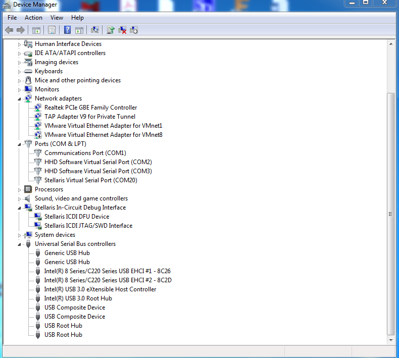

  • Hello Anamika,
    Can you please post a screenshot of your device manager before and after the device is plugged in so I can see exactly how the device is enumerating in the system?
    Also which OS are you using, Windows 10?

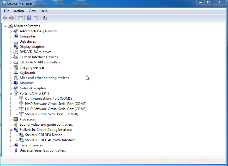

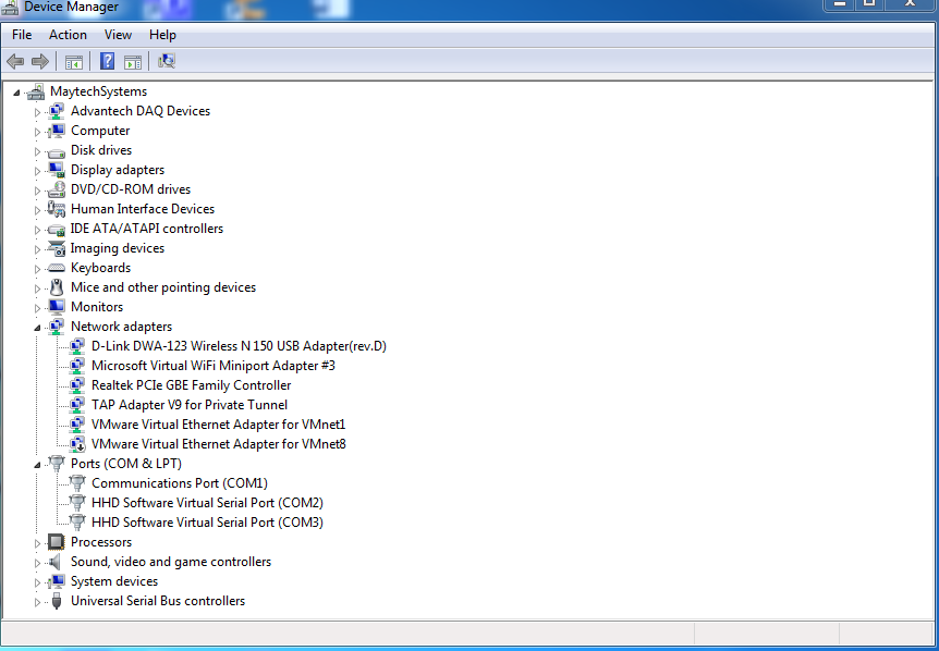

  • Hi Ralph Jacobi,
    Thank you for your quick response.
    When device is not plugged in...
    and I changed the JP1 POWER SELECT from ICDI to the OTG position , and device is plugged in .... at that time my device manager is detecting nothing like below...
    When I was connected to the USB Debug port , it is detecting like below
    I am using Windows7....
    Thanks & Regards
    Anamika
  • Hello Anamika,
    Thank you for the comprehensive screenshots.
    Some items to check to try and resolve this issue:
    1) Are you programming the device with CCS? If not, can you do a Verify for the program?
    2) When plugging in only the cable by the Ethernet port and switching the jumper to OTG, does the power LED come on for the LaunchPad?
    3) With both cables plugged in and the power jumper set to ICDI, do you see anything different?
    4) With both cables plugged in, can you look inside of 'Universal Serial Bus controllers' and see if there are any devices showing up as not installed properly?
    5) Can you try using a new USB cable for the Bulk device port? Occasionally a faulty cable can be the root cause.

  • Hello Anamika,
    Those examples look fine. Can you try with a different PC? I've tested them on a couple Windows 7 PCs and did not have any issues on my end. That's about the only idea I have right now as they have been working fine out of the box for everyone else. If a different LaunchPad had the same result then I'd suspect the issue is a Windows one.
  • Hi Ralph Jacobi,
    Sir I was tried on a different windows 7 PCs and also with different Launchpad but I am facing same problem.. Let me confirm am I doing wrong procedure after dumping the program into Launchpad..
    I followed Below procedure...
    1)After dumping the program into Launchpad.. I am removing the Debug USB cable which is connected to the PC.
    2)I am changing the POWER SELECT JP1 jumper from ICDI position to OTG position and I connected USB cable to the USER USB PORT which is nearest to the ETHERNET PORT...that USB cable is I am connecting to the PC...finally the Launchpad is getting POWER but no port is detecting in DEVICE MANAGER.
    Can please give me the procedure from after dumping the program onwards....
    Thanks & Regards,
    Anamika
  • Hii Ralph
    I have tried with the different PC also but still facing same problems.
    1. I am unable to install the usb_dev_cserial.inf driver,I get the error "The INF file you selected does not support this method of installation".  I am
       using Windows 7. When I am manually installing the Drivers and after that when I am checking that driver installed properly or not, its showing
       "The device can not start Code 10". You can go through the below screenshot of device manger of 2 different PC's
    2. After dumping the code, in UART terminal last TEXT is showing "Waiting for HOST".
    Thanks & Regards
    Anamika
  • Hello Anamika,
    Okay so this looks purely to be a Windows driver issue. This isn't an issue with your LaunchPad or the code you are loading in, or the power process.
    The only thing I can think of to try right now is give these older drivers from a pre-Windows 10 TivaWare release a try. Maybe they would work better with Windows 7. I don't expect this work as no other Win 7 users had issues with the latest drivers, but it's worth a try given you have had the issue on multiple PCs: windows_drivers.zip
