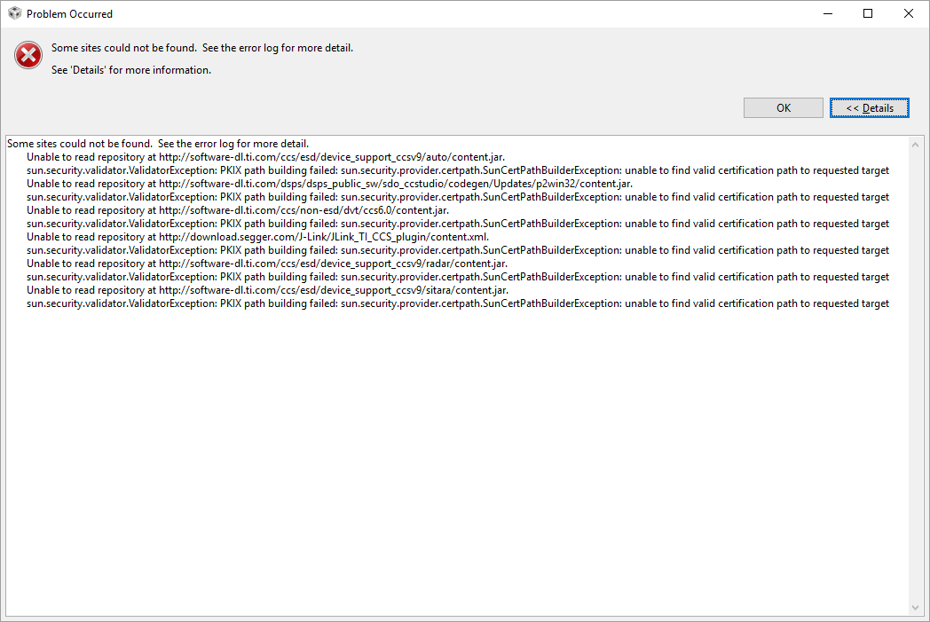

  • I tried updating just now again and have different problems. It either gets errors or doesn't even find the update anymore.
    First I got a "computing size" error. So I cleaned up the cache as described at software-dl.ti.com/.../ccs_troubleshooting.html
    Then I chose to update CCS from Eclipse itself as I did the first time. I get:

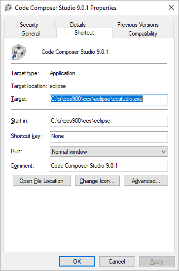

    And interestingly, a new shortcut saying CCS 9.0.1 appears on the desktop but it points to the older version of CCS. (Misleading shortcut).
    The version of that ccstudio (the current one installed) is 9.0.0.0018
    That error has been reported in the past. It is something we don't have a good answer for. Please see:
    https://e2e.ti.com/support/tools/ccs/f/81/t/745390

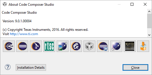

    This will happen if you do an incremental update from 9.0.0 to 9.0.1. It will update the CCS in the 9.0.0 directory. The directory name remains the same. As for the version number in the Help, that should change. I'm not sure what happened there.
    Subu Rama said:
    If I attempt to restart ccstudio and attempt the update again from within it, I now get "no updates found".
    I think the update was successfully installed, just the version number not properly updated. I think it may have to do with the error messages you saw earlier. While the CCS update worked, other updates did not. This may have screwed up the update process (like not updating version numbers)
