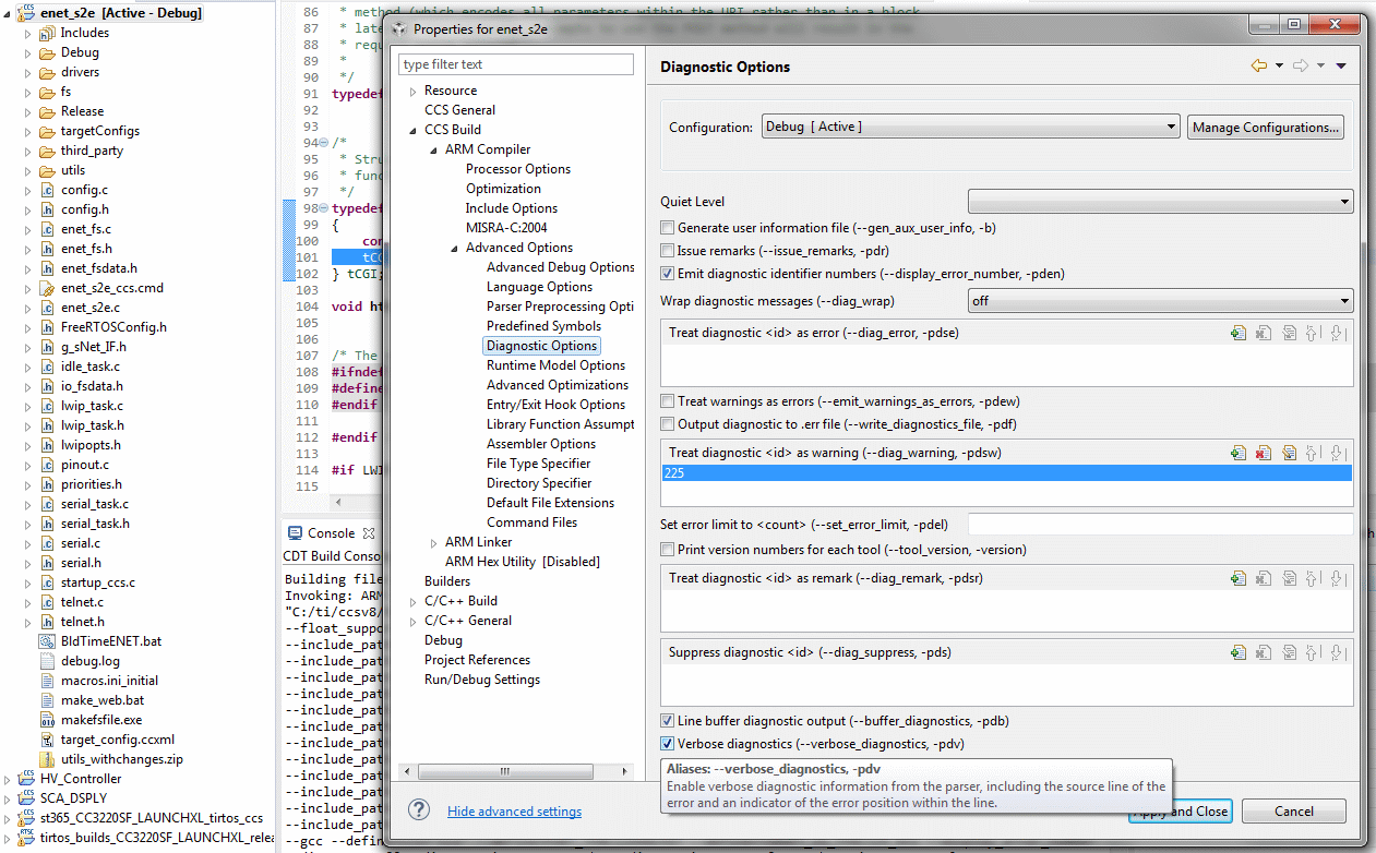

  • Try adding the build option --verbose_diagnostics.  It causes the compiler to echo the problem source lines with a mark next to the point on the line where the error begins.  It often makes it easier to understand the diagnostic.

  • Chester,
    Thanks for pointing out the warning regarding the file "lwip_task20190426_1300.c"
    That was my clue. That file was not part of the project It was a copy I made of the file lwip_task so I could back out some changes. Apparently after restarting my computer the project picked up the file and then choked reporting an error.  Not sure why that all happens, but when I delete the file I can build with our error.

  • Hello George,
    Thanks for the tip on verbose diagnostics.
    I have already cleared the error (and hopefully learned from my mistake) that caused me to start this thread.
