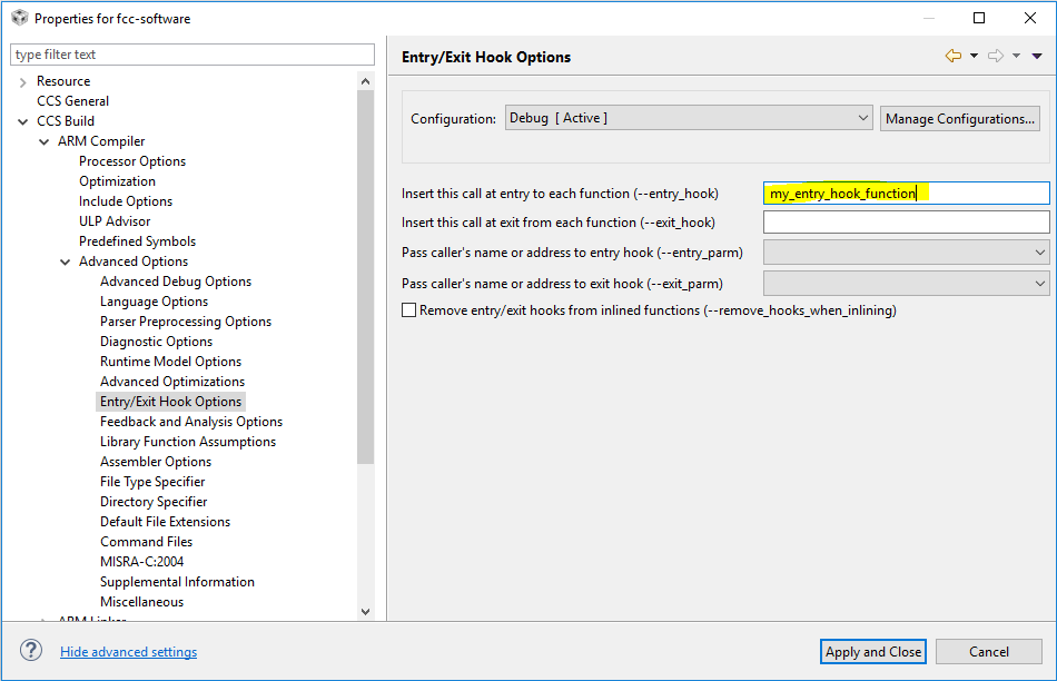

I'm attempting to use the entry/exit hook functions to monitor stack usage in my program as described in SPNU151. In the process of debugging this feature, I've discovered that once I enter an entry hook function name in the "Entry/Exit Hook Options" dialog box, as shown in the image below, that I can't get rid of this entry. If I delete the entry, e.g. delete "my_entry_hook_function", the .cproject file retains the default entry hook directive, causing my build to fail.
.cproject after I input the name of my entry hook function
<option id="com.ti.ccstudio.buildDefinitions.TMS470_18.1.compilerID.ENTRY_HOOK.2064082480" superClass="com.ti.ccstudio.buildDefinitions.TMS470_18.1.compilerID.ENTRY_HOOK" value="--my_entry_hook_function" valueType="string"/>
.cproject after I delete the name of my entry hook function
<option id="com.ti.ccstudio.buildDefinitions.TMS470_18.1.compilerID.ENTRY_HOOK.2064082480" name="Insert this call at entry to each function (--entry_hook)" superClass="com.ti.ccstudio.buildDefinitions.TMS470_18.1.compilerID.ENTRY_HOOK" value="" valueType="string"/>
I can work around this by manually editing .cproject but it's a nuisance and will likely trip up someone else. It should be fixed!

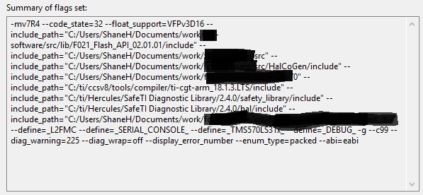

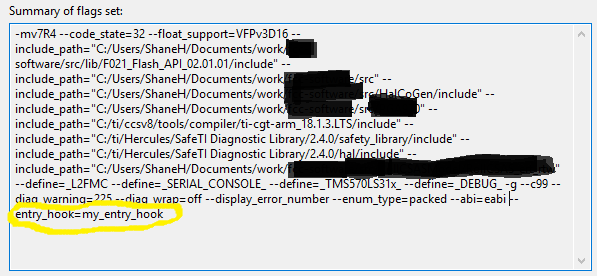

    Which version of CCS and compiler tools are you using? I tried a quick test to reproduce this but could not, so it may be specific to a version or to your project.
    After you delete the function names in the --entry_hook and --exit_hook fields and rebuild, do you still see them appear in the list of compiler options in the build console? Could you capture the build logs with and without the option populated and send it to us? Also please provide the versions of CCS and compiler tools? I will try to reproduce it with those specific versions.
  • Code Composer Studio  Version: 8.2.0.00007
    TI ARM C/C++ Compiler  v18.1.3.LTS
    compiler options with --entry_hook specified
    compiler options with --entry_hook removed
    From the screenshots, it looks like it removed the option as expected, so could you elaborate on how the build fails?
    If there is a build error, it would be helpful to see the build log. If you could save that to a text file and attach here that would be great.
