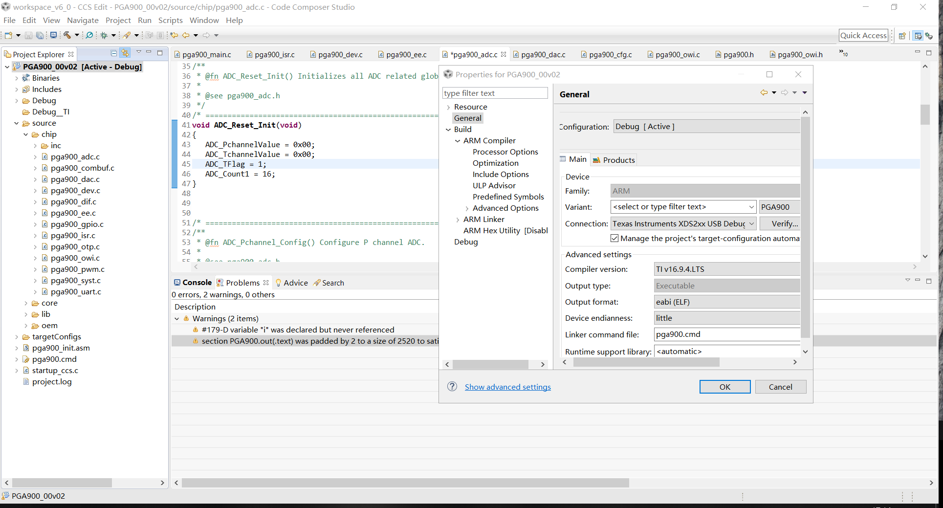

When i build project ,such warning appear.

I can only help with the warnings you see when building the project. To explain what I happened, I need to reproduce it. To help with both of those warnings, I need the CCS project. Please zip up the project according to the directions in the article Sharing Projects, then attach that zip file to your next post.

PGA900FirmwareGeneric-1p5.rarI use the TI example project ( PGA900FirmwareGeneric-1p5.rar).
I am using PGA900EMV development board and Code Composer Studio v7.3.0.00019. I want to use XDS200 USB JTAG emulator to program PGA900.
PGA900 Software Quick Start Guide (SLDU015A) suggest me use Code Composer Studio v5.5.0.00077
Unfortunately, I am unable to reproduce the errors. I can give you a general explanation of these errors, but not a specific recommendation for a fix.
Regarding the first warning about the variable i ... That is saying you have a source line similar to ...
int i;
But the rest of the function never uses the variable i. To avoid the warning, remove the declaration of i.
Regarding the second warning about section was padded by 2 ... This comes from the hex utility. The text section must be of size 2518 bytes, which is not a multiple of 4. So 2 bytes of padding are added to the end. One way to avoid this warning is to apply the palign directive to the section text in the linker command file. Read more about palign in the ARM assembly tools manual.

hello George。
I find the error,
It cause by code composer studio→Optimization.
When I turn off optimization level and Speed vs. size trade-offs to 0,it work well.
