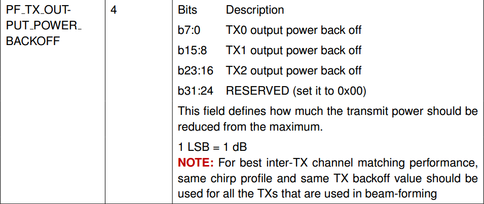

1.The parameter description given in the user manual is shown in the figure above。

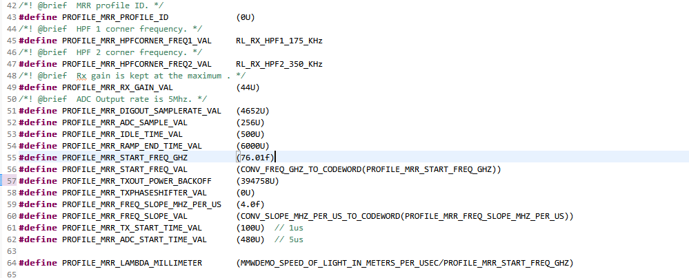

2.I set this parameter to 394758u(0x060606), and then I tested it and found that it had no effect on the maximum distance. Okay?Or is there something wrong with the parameters that I set?
