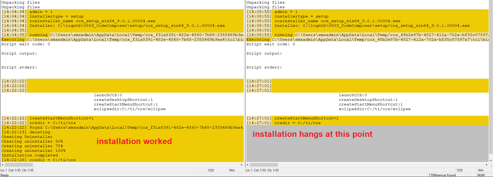

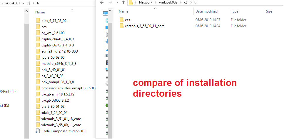

On physical computers the silent installation works without problems, but on virtual machines we have a strange behaviour. Sometimes the installation hangs at a certain point without an obvious reason. The setup.exe is still running but it does nothing for hours.
OS is a clean Windows 10 (1809).
What we've tried so far:
  • Installing the software over GUI -> works fine
  • Autologon of the user who installs the software (admin) before the installation starts (screen not locked)
  • Disabling Windows Defender during installation (with Powershell command or Group Policy)
  • Comparing the log files of working and not-working installations -> no errors found

    Interesting; the log files show the installation goes quite ok up until the very last bit, thus the problem seems to be either in creating the shortcuts on the desktop area or something else. Despite we don't officially validate CCS on VMs, the differences between the VM and the physical machine shouldn't matter, apart from aspects such as network access problems (which shouldn't influence this), virtual disk or other machine settings (delays in disk access, power saving issues, etc.).

  • Thanks for the fast answer. Here are all the logs (VM - working / VM - hanging / Physical - working) and our optionfile:
    install_logs_2.zip
     Our VM engine is Hyper-V Version 10.0.14393.0.

  • We tried to disable the shortcuts in the option file but the setup is still creating desktop and start menu shortcuts. Behavior still the same, on one VM it works on the other not.

    Could you please run the install on the vm where it's hanging with the additional parameters below:
    --syncdebugtrace c:\temp\debug.txt
    where c:\temp is a folder that exists and is writable.
    Thank you,
    Danish
  • Thank you for your answer. Here's the logfile.debug.txt

  • I tried the installation with the parameter, but the result is the same. One VM hangs, the other one works.
    The CCS temp folder (C:\users\<username>\appdata\local\temp\ccs_...) is also present without the "--test true" parameter at the time the setup hangs.
