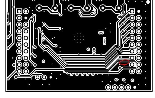

    1) Populate the following three capacitors for phase voltage feedback if they are not pouplated on the board.
    -  C9, C10, C11 -> 0.1uF
    2) DRV8323RH’s GAIN pin(32) should be Hi-Z to be 20V/V which is default setting of DRV8323RS’s firmware. To do this, you need to carefully cut the line between DRV8323RH GAIN pin(32) and J4 pin(18). This line is located on the pcb bottom side. Pls refer to the picture below.
