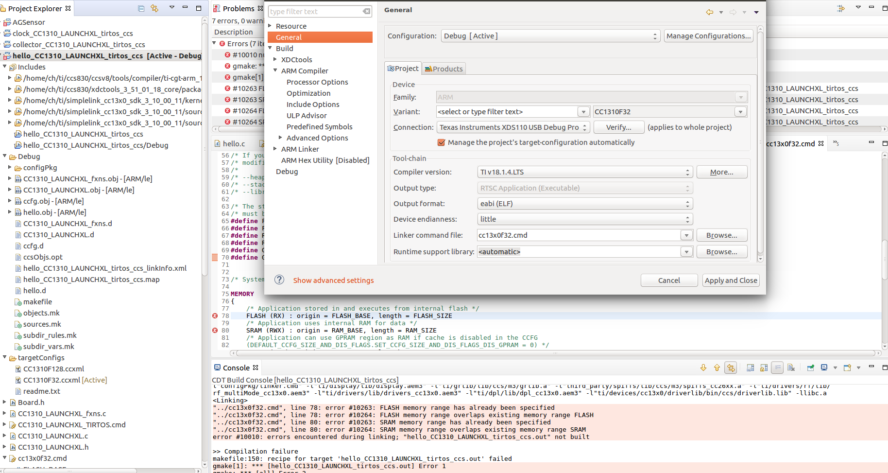

CCS/CC1310: memory mapping in custom CC1310F32RHB
Part Number: CC1310

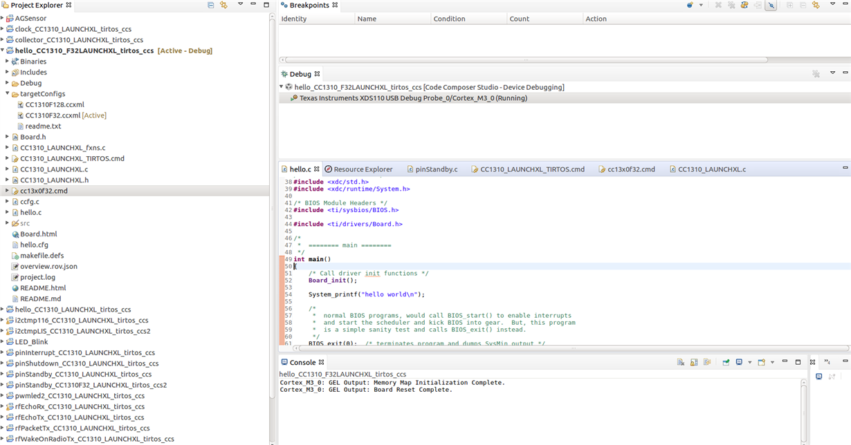

I just tried flashing Hello world But in the console it says this
Cortex_M3_0: GEL Output: Memory Map Initialization Complete.
Cortex_M3_0: GEL Output: Board Reset Complete.
Cortex_M3_0: Loader: One or more sections of your program falls into a memory region that is not writable. These regions will not actually be written to the target. Check your linker configuration and/or memory map.
What changes need to be done in CC1310_LAUNCHXL_TIRTOS.cmd file ?

  • Hi Tomasz,
    Here's the attached map file.
    Could you please link me to the memory region example?

  • Hey,
    I have done these changes in Preference >> General,
    But getting an error:
  • You cannot flash your out file.
    There is a compilation error.
    Please show me your cmd file.
  • Did you check map file ?
    Here's the cmd file :

  • Please, do the following changes:
    #define FLASH_BASE 0x0
    #define FLASH_SIZE 0x8000
    #define RAM_BASE 0x20000000
    #define RAM_SIZE 0x4000
    then build and show your full Console output.
  • I have made those changes Please see the console o/p and could you please explain me how those numbers?
    It is supposed to print " Hello world " but it's not :(
  • Your memory mapping issues is fixed.
    Please, mask this thread as resolved.
    To fix System_printf() issue, you can start read some tips here:
    software-dl.ti.com/.../sdto_cgt_tips_for_using_printf.html
  • Yea sure.
    But Could you explain me how did you calculate this:
  • It is based om CC1310F32 datasheet.
    Memory block origin base address and sizes are stated there.
  • Depends on document version. I do not know.
    Check memory mappings.
