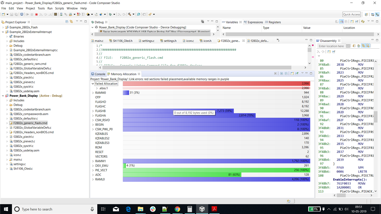

Here, i am using to RAM blocks i.e. RAMM1(origin = 0x000100, length = 0x000700) & RAML0 :(origin = 0x008000, length = 0x001000 ).
See the memory allocation details below:
I am getting this type of error :
"../F2802x_generic_flash.cmd", line 160: error #10099-D: program will not fit into available memory. run placement with alignment/blocking fails for section ".ebss" size 0x1c17 page 1. Available memory ranges:
RAMM1 size: 0x700 unused: 0x0 max hole: 0x0
RAML0 size: 0x1000 unused: 0x0 max hole: 0x0
error #10010: errors encountered during linking; "Power_Bank_Display.out" not built
I have one more RAM block left with which can found from the memory mapping of the F28027 controller, but when i try to access that particular block i am unable to get the expected results, with the fine code as well.
Can any one tell me the alternative?

  • The size of the .ebss section is much larger than the combined sizes of the memory ranges RAMM1 and RAML0.  You need to work out why it is so big, and see if there is some way to reduce the size.  Look in the map file at all the files which contribute to the output section .ebss.  Maybe there is one file that takes up most of the space.
    Thanks and regards,
    -George

  • Please see this FAQ (not from TI) which explains how variables are typically declared and defined in C source.  The main point is a global variable is associated with the one C source file which defines it.  Next, read the first part of the article Linker Command File Primer to get an understanding the terms input section and output section.
    A source file that defines some global variables contributes an .ebss input section to the overall .ebss output section.  You can see this in the linker map file.  Consider this simple example ...
    .ebss      1    00000000    00000002     UNINITIALIZED
                      00000000    00000001     f2.obj (.ebss)
                      00000001    00000001     main.obj (.ebss)
    The file f2.c (which could be f2.cpp) contributes an .ebss input section of size 1 word.  The same is true of main.c  The size of the .ebss output section is 2 words.
    I suspect one source file is contributing a very large .ebss input section.  Use the map file to identify that source file, and see what might be done about it.
    Thanks and regards,
    -George
