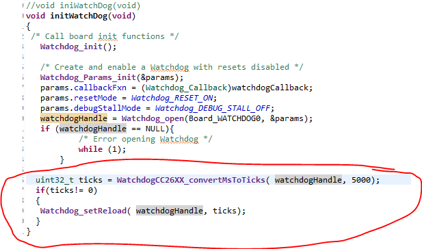

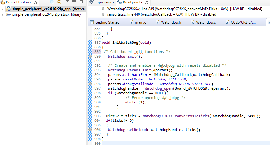

here, is my watchdog code implementation

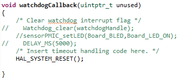

and below is the WATCHDOG calback function

    The Watchdog_clear function is commented out to check the timeout.And this Watchdog_clear is kept inside a periodic clock handler. But this is commented out to check the watchdog timeout.
    Our problem is we are not getting watchdog timeout at 5 secs(as shown below) and instead getting at 120secs.so we are unable to get the reset at 5sec.

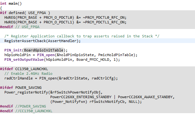

    In the main .c code we have already disabled the power saving.(as shown below)
    Then what could be the problem for getting  watchdog timeout at 120 sec?
    Roopa
  • Hi Roopa,

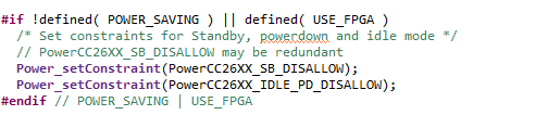

    I can't see that you have disabled power saving in that screenshot.
    Add this to mian.c before BIOS_start() to check if the 120 second thing goes away:
    Power_setConstraint(PowerCC26XX_SB_DISALLOW);
    Power_setConstraint(PowerCC26XX_IDLE_PD_DISALLOW);
    Aslak
  • Hi Aslak,
    I have  enabled the USE_FPGA in the main .c function(as shown below)
    but there is no improvement .still the Watchdog timeout is happening at 120 secs.

    We have added these to main.c before BIOS_start() and the 120 seconds timeout problem is solved. With these constraints, we get Watchdog timeout every 5 seconds as programmed.
    These constraints give NO POWER SAVING to our application.
    We want to have POWER SAVING without these power constraints. In that case, we understood that we will not have the WDT ticking while app is in standby. We need to effectively plan WDT ticking and we will work on this further.
