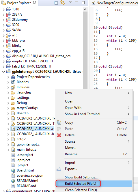

CCS/TMS320F280049C: how to complier/build a single file, not a completed project, with CCS9?
Part Number: TMS320F280049C
Customer is asking how to complier/build  a single file with CCS 9, since it takes a long time a complier a completed project every time when something changed. He said that it is possible to do it with CCS 3.3.  How about CCS 9?
